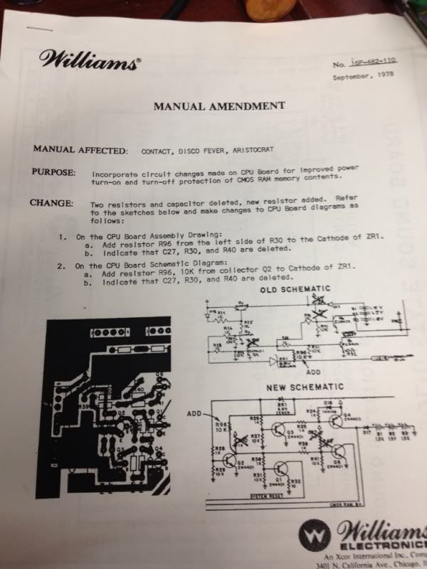

There was a manual amendment for Williams games Contact, Disco Fever, and Aristocrat.
My question is: Do I physically remove C27, R30, and R40?
Does anyone have a picture of this mod completed?

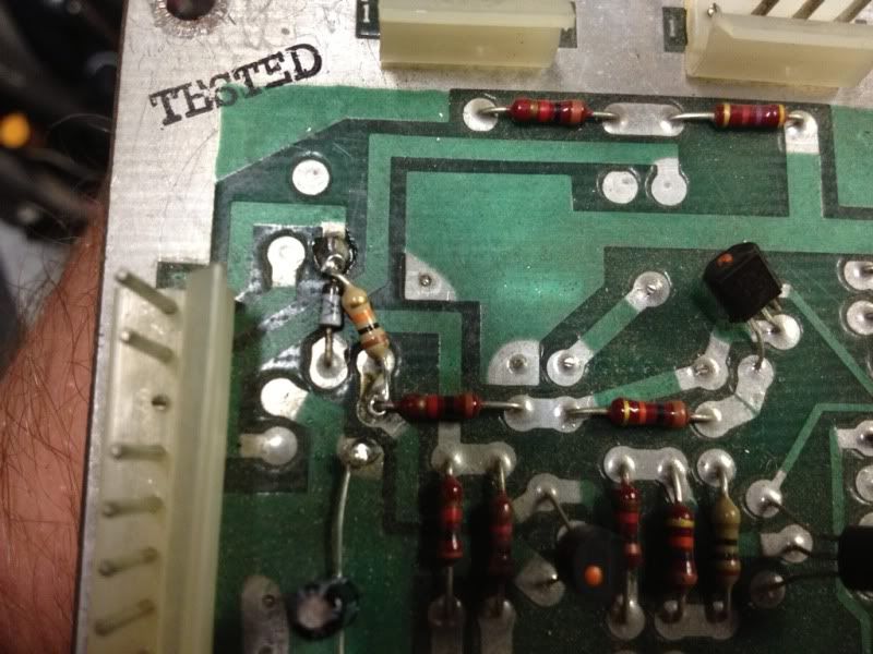

Here's a picture of the circuitry change after the manual amendment:
