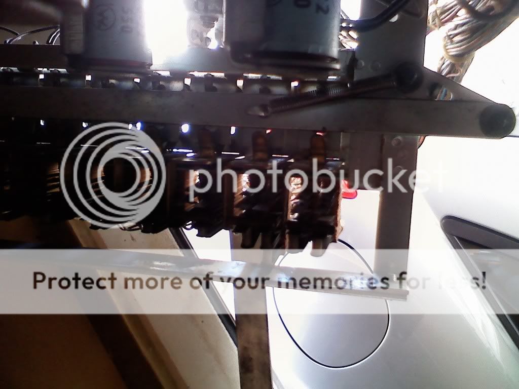

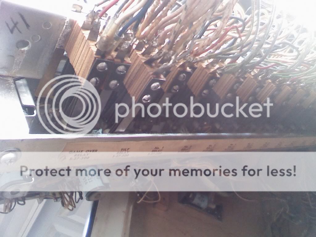

finally took pictures of this hopefully someone can help.
had to replace the coil, and i thought i had put it back together the way it came apart, but at that time in the middle of the night i only must have had one eye open. any help would be great

see how a set of contacts are sitting too low. not sure what or where i got them from. but you can see in one of the pictures that the roller is sitting to low, and there for it will not reset for tilt.
It looks like the roller actuator is on the wrong side of the leafs in this picture. Hard to tell without seeing how the switch positions are though.

i sent you a private message reply about the blade order.

back in working order. thanks yaggy for the color code print out.
