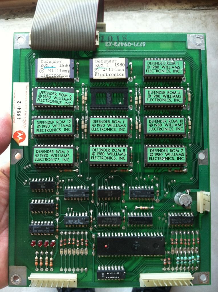

Not sure what part of a Defender board this is, but see below.
If you know, please reply to this thread.
No way of testing and no idea of value. Selling as is. Highest offer, gets the board. - SOLD!

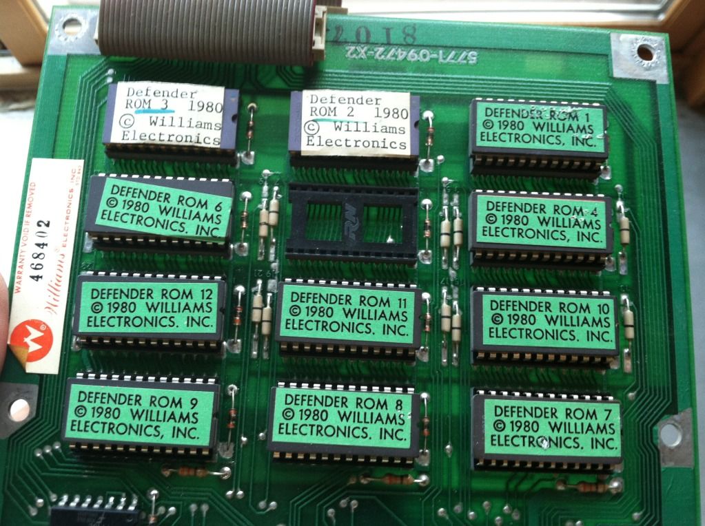

That is a complete Defender ROM board. ROM 5 was never used. It was supposed to be for "future enhancements" which were never released.
ken
Looks like a clean board.
Also worth noting, it has an older "green-label" eprom set
which will not work in a cocktail Defender.
(... you need the "newer" red label set for the cocktail )
As for price, given that's it's untested but looks clean and complete,
I'd say about $20.
Good luck.
