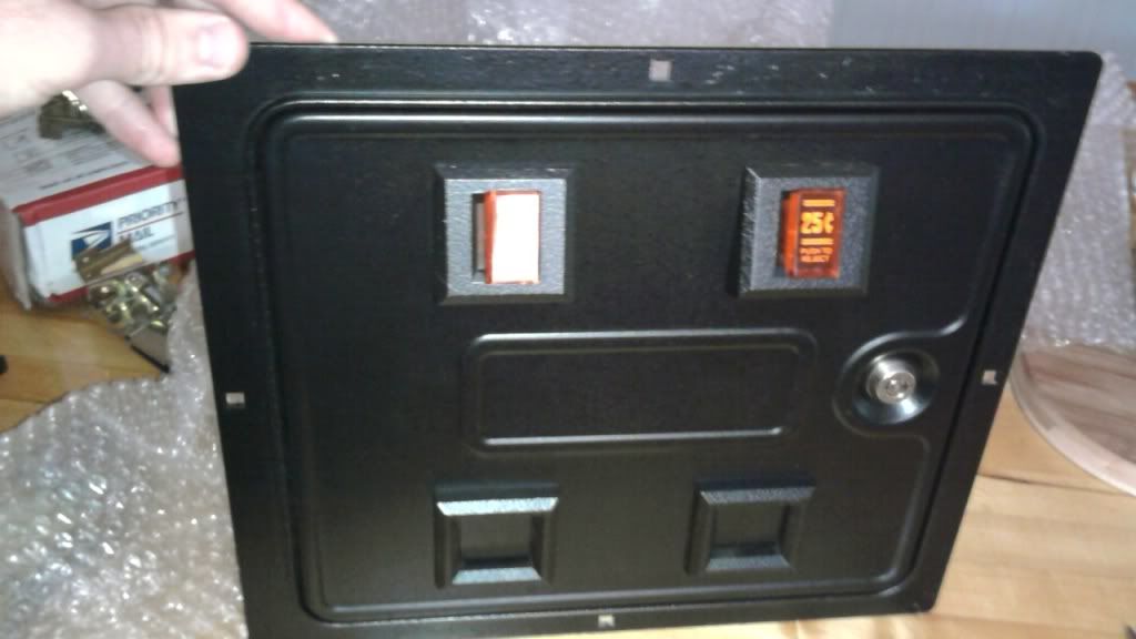

I'm bad at describing things like this, but here are some pics of the NOS Coinco door I got for my Bubbles. I hope this helps!
Before installation:
With camera flash off:
With the flash on:

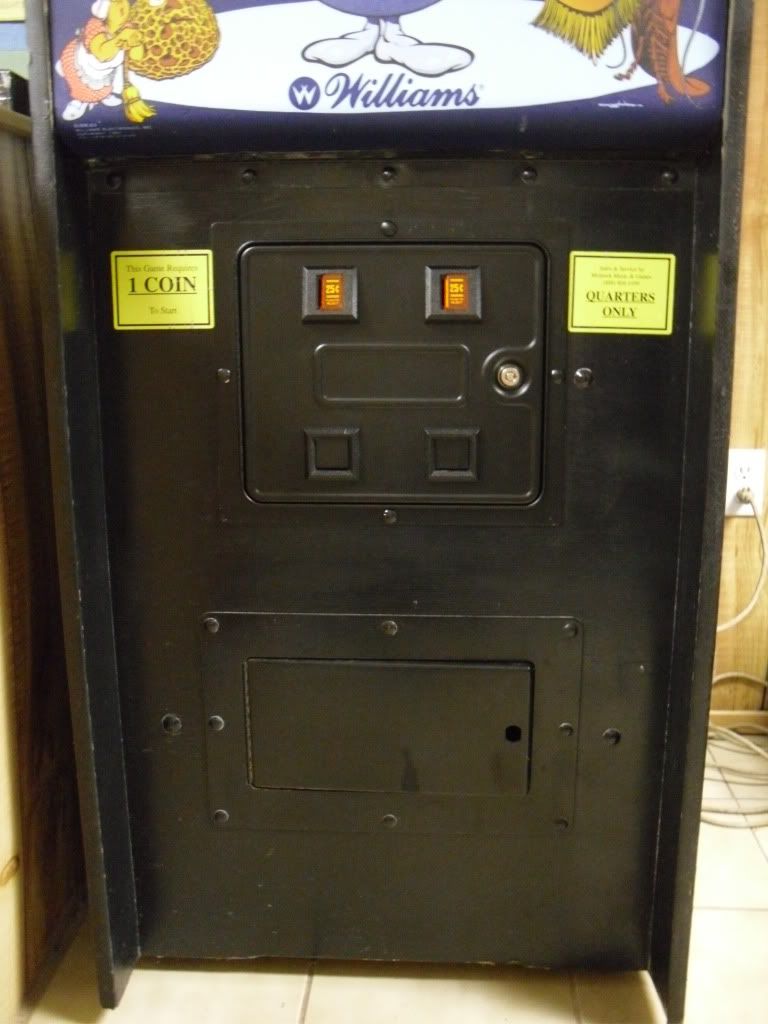

You can see the texture semi well on the top door in this picture. thanks
Added picture to first post
I got lucky and found a door without scrapes or dents.
I just cleaned it up,went over it with acetone and repainted it.
It has the original texture and fresh paint.
