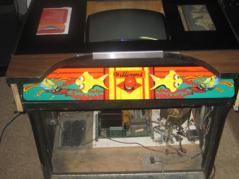

Hey,
I'm trying to figure out how to set up the control panel on my Williams Cocktail, but I'm not sure what/how to do it. Anyone how there have any experience with this?
I'm just messing around with it for now, but I'm going to measure and cut another board after I figure out what I need to do. I also need to figure out how to back-light this thing.
Any help is appreciated! :D
Here's my control panel:

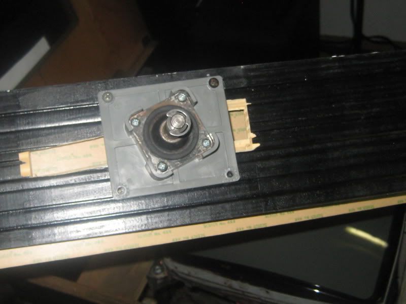

The back of it... Yeah, I know.
Backlighting is done via the 6.3VAC general illumination power from the power supply. You add bayonet sockets and #44 or #47 light bulbs where you want the light to shine through.
You also appear to be missing the top part of the joystick. The part that holds the leaf switches.

Honestly, that CP looks horrible. Don't mount NOS overlays on that. If you need help, let me know. I can cut REAL CP's for you that will look great. And BTW, Make Trax didn't feature backlit CP's (to my knowledge).
Also, if you are thinking about putting a Multi Williams in one of these, I can cut a CP for that too. Just let me know what you need and give me dimensions.
Oh, I was just messing around with some leftover wood we had from refinishing the baseboards in the bathroom. I wasn't entirely sure how the control panel was suppose to fit in, so I decided to try it out with some old crappy wood.
I'm probably going to go by home depot soon and see if they will cut some wood for me. (I don't like to work with wood) But if they cant, then I'd love to take you up on your offer. Can you drill the holes too?
