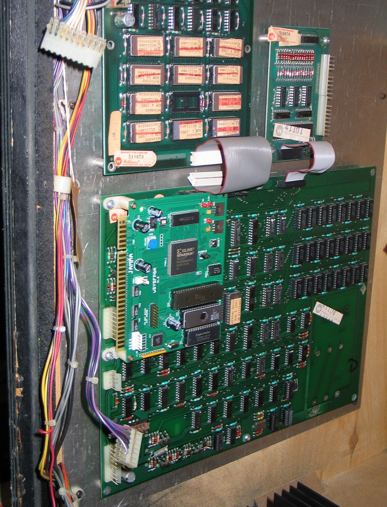

The boards come with:
6 pin wired input header for buttons 5 & 6, high-score-reset and 'menu' button
2 pin wired output header for H & V syncs
2 mounting feet
For mounting in the original cabinet - see the mounting picture link
2 x #8 machine screws 3/4" length for mounting the feet to the original metal plate
2 x metric screws for attaching the board to the feet
2 x spacers for short feet only ( these are 12mm spacers for extra height needed to clear the board connectors). The 3/4" or 1" feet don't need these.

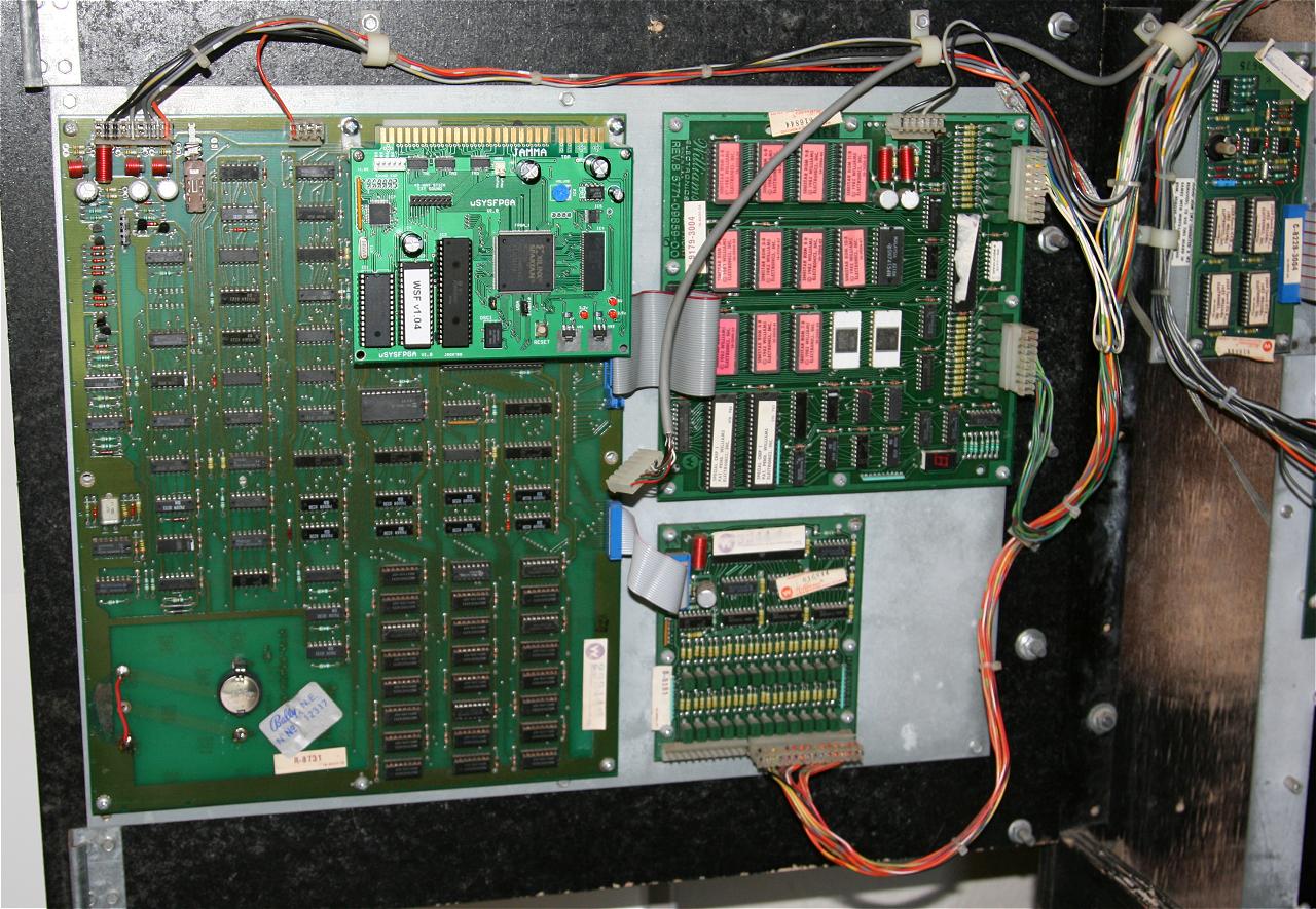

<u>Board Mounting</u>
Robotron/Joust/Stargate/Sinistar/Bubbles/Splat sytle
Door mounted cabinets
Defender
Defender cabinet
