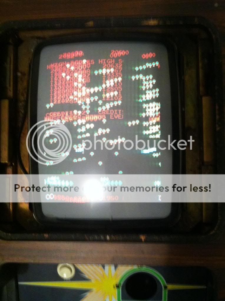

Will caps solve this sync issue?
hovo
Aug 13, 2010
114
0
quebec, Canada

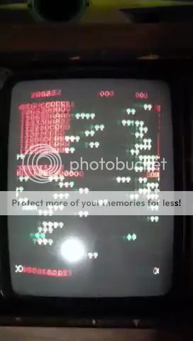

My electrhome Go7 Fbo all of a sudden starts acting crazy. It appears to be a sync issue. Ive ordered some caps for it, but just to be on the safe side, will that solve the problem?
THANKS ALOT IN ADVANCE
i would try adjusting the hold pots on the monitor chassis first.
a cap kit is a good thing to do to any G07 of that era.
Peace
Buffett
Saw one like that - the degaussing coil had fallen off the back of the monitor. Check yours - it's the tape wrapped loop that goes around the back of the monitor. For some reason, if it falls off the monitor gets snaky like that.
caps!!
Should use the service test pattern for monitor video
to diag the monitor not game play..
the issue has to do with the vertical circuit
Needs a cap kit and clean the pots etc.
is a good place to start.. Good Luck!
