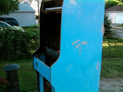

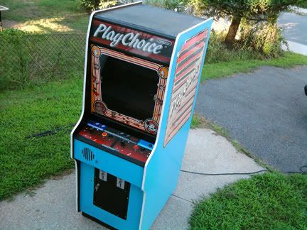

The movie prop cab in BTTF2 was actually a duel monitor Playchoice cab with only one monitor in it. The game play animation from the movie look like flash animation. I dont know. I didn't see the point of using a tall Nintendo cab for this when a DK style cab would work. I waited a year to find a short style Ninty that was converted to a Playchoice to pop up. Haven't seen one since.

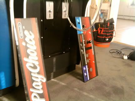

Custom marquee made in photoshop.
I added the copyright logo,
In the youtube video from above at 24 seconds you can see it was Playchoice side art on the cab. At the very beginning of the video too you can see the Wild Gunman (Playchoice) title screen.

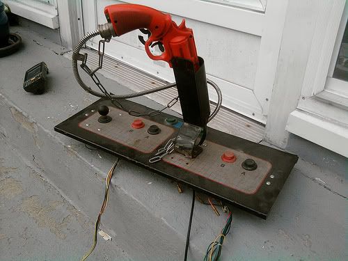

An old beat-up VS control panel, begging to be used.
I bought a freshly refurbished gun from klov.com's very own slinkmasterflex. Its wicked pissa guy.
I changed the button layout alittle. Since there's only 1 player games on this cab I figured I'd be hitting the "Start" button alot more than "Select" so I rigged the "Start" button to use the "1".

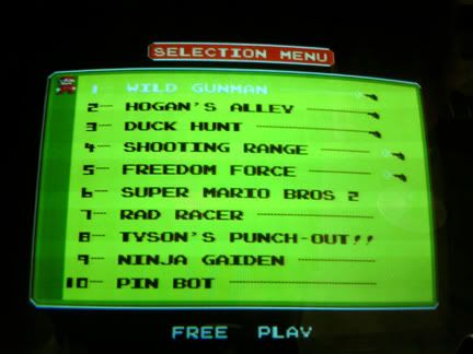

I already have a dedicated Playchoice loaded with Co-Op games, so this cab is only shooters and one player games. Also this is a hacked version of the Playchoice bios allowing me to add two more shooting games not released on the Playchoice before, Freedom Force and Shooting Range. I didn't say they were good games, just getting more use out of the Light Gun.
Another reason why I think I went with a VS gun holster is because in the movie prop version of this cab the holster was high close to the control panel, the Playchoice's gun holster was far too big to mount there or even below near the coin door.
Regardless of what section it is in, AWESOME job. Looks great! I always hoped someone would take on that project. Thought I was the only one! Very...very nice.
I think the reason they used the two monitor version for the movie prop was so they could rig it up to mount the monitor flat and a little higher. How is the game play with the monitor tilted back like that?
