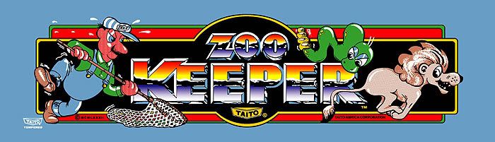

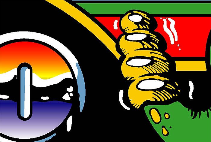

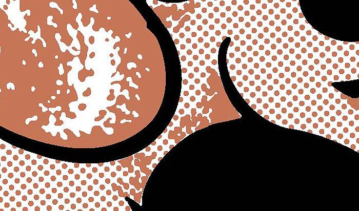

I've done a prototype marquee for a local KLOV'r with my file. I traced it from hi-res scans. The only thing I haven't finished is the halftone effect in the "Zoo Keeper" text.
I decided to stop uploading my art to the library when all the inkjetters were profiting on everyones hard work.

PM me if you need any tips on the halftones. I was able to blend vector with raster for my ice cold beer side art. Learned more doing this art than in my 15 years of graphic design. Especially usefull when the final output isn't screened. I've been told by a little bird the marquees will be happening but the art wasn't done yet. Maybe they should contact you.

I quoted the marquees for Anthony over at QA
but that didnt include artwork.
The Halftones are generally created in the film pos stage so if your going to screenprint
SO DONT WASTE YOUR TIME ON THOSE
but I would contact Anthony to see if hes interrested in your artwork to help make this happen.
One of the things that can make projects diffiucult and expensive is the art
prices for screenprinting are based on a per color basis.
Artwork needs to be vectored then color seperated adding traps and bleeds to each color.
You cant just take a scan and screen it.
Some art is pretty straight forward Mario Bros. lots of colors but not much hand drawn detail pretty clean lines most Atari art is another example of easy to do art
thats why we see so much of it even without orginal films
the more hand drawn art there is the more diffiucult it becomes.
So more complex pieces are just more difficult to do and sometimes the demand just dosnt warrant the extra work. and it mostly comes down to $$$
Course theres always too many projects soo little time
and the needs of the many will always out wasy the needs of the few or the one.
But ZK marquees should and will be done at some point soon I would think.

I used to run an imagesetter at a printing company. I had a graphic design business in the 90's as well. I know all about halftones :)
I "fake" the halftones for use on an inkjet.
I found a really cool plugin for Illustrator , PhantasmCS, that does a fantastic job on halftones. It took a while to learn the program but the end results are outstanding.
