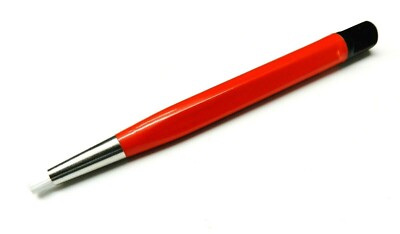

The root cause of that is not the AR itself, but rather the edge connector fingers on the game boards getting a layer of oxidation built up on them. This issue has been discussed in many threads here, and is common to Atari games.
If you get the AR's rebuilt without fixing the root cause, it'll just happen again eventually.
The solution (in addition to replacing that burned 10-ohm 1/4 watt resistor, and replacing the 2N3055 bottlecap, which should be done on all original AR's) is to get a fiberglass pen and some DeOxit, remove and separate both boards in the game board stack, clean all fingers with the fiberglass pen until they are shiny, clean the residue off with Goof Off or isopropyl alcohol, then apply DeOxit to them. Links to what you need below.

Thanks yeah. I was perplexed because my edge connectors looked great. Then upon further inspection when putting the rebuilt ARII's back in I found a bad wire connection in one of the connectors going into the the ARII that had burned out. Everything working fine now I'm thinking/hoping that was it.
Yep, that would have done it.
