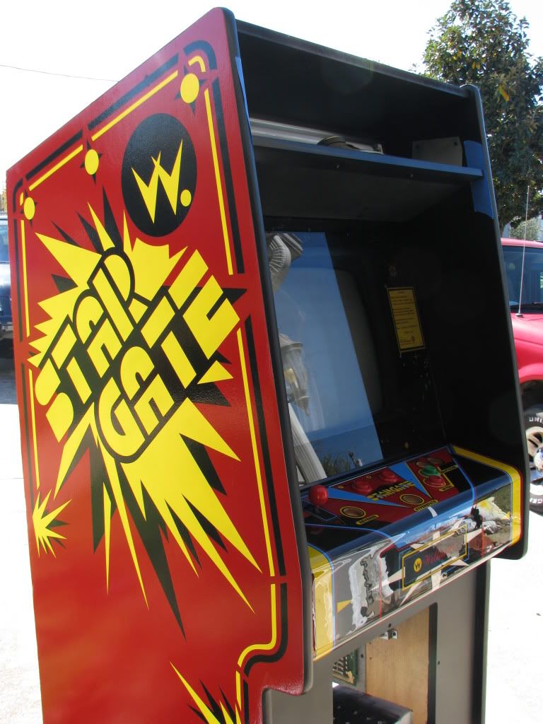

I would say that the first time you stencil a cabinet, you will definitely make some mistakes. I feel I did the Stargate right, but it was after some DIY stencil fails on a pinball project, so I had a little bit of experience at this point.

The key to stencils being easy is this... automotive lacquer. Not everyone is set up or ready to use that kind of paint so the default go to is rattle cans or home depot paint.. that route works but like people have said, it's messy, time consuming and often difficult to judge when to remove the stencils.
Now, when you use automotive paints all those issues go away. Paints dry almost instantly, stencils can be removed mere minutes after painting with zero concerns about tearing or flaws.. not to mention the color gamut that auto paints can match when a talented paint mixer is on it.
The down sides, you MUST wear a respirator, MUST have hvlp gun and must have more cash as custom mixed paints will cost about 40 bucks a quart. Luckily, base colors are readily available at auto part stores in addition to primers.
