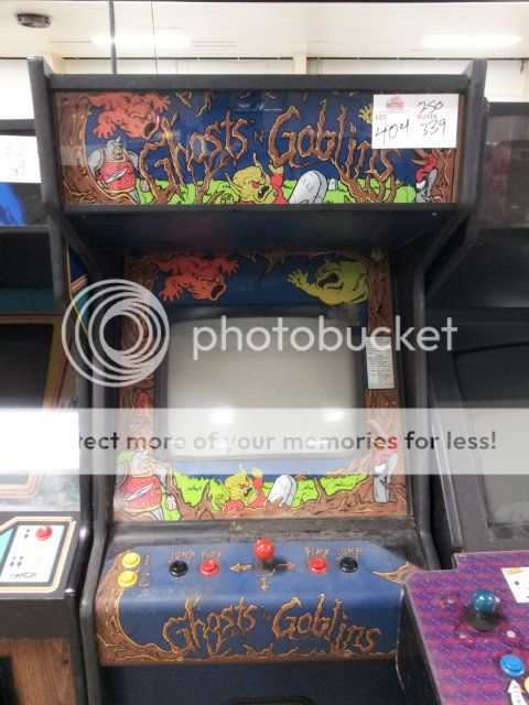

Does anyone have a picture of a real Ghosts 'n Goblins cabinet.
I think I found an abandon empty one that I can rescue, but I gotta see one from a real owner.
I dont want to bring the wrong cabinet home.
I know the klov has some picture but all are not Accurate. (Karnov is the best example)
Could the proud owner of this game please provide me with a photo?

The original cabinet looks like the one shown here on VAPS:
http://www.arcade-museum.com/game_detail.php?game_id=7938
...and... Here's another member here on KLOV with one for sale (looks just like the one on VAPS.)
http://forums.arcade-museum.com/showthread.php?t=237869&highlight=goblins
It is very similar to a Dynamo HS1 cabinet - EXCEPT, instead of the 'bump' in the profile of the cabinet where the control panel is, the cabinet is extended flush with the control panel all the way to the ground.
If you try and use an original Ghosts N Goblins control panel on a regular HS1 cabinet, you will find that it just wont look right.
If you have access to the cabinet, snag it! You don't see many Ghosts N Goblins left in the wild!
-MUEL
That's what im talking about.
So would you guys agree, this maybe it? Its minus the control panel.
It just caught my eye. they are going to chuck it.
I'll pick it up tomorrow.
If it will help you, I just measured an original CP that I'm going to put in a cabniet (when I find one - LOL):
23-3/4" wide - standard width for Dynamo HS1 also..
That cab looks like a 'GO' to me!! Free, heck I'd take it anyhow!
She is 23 3/4. I measured that when i saw her.
Picking it up tomorrow.

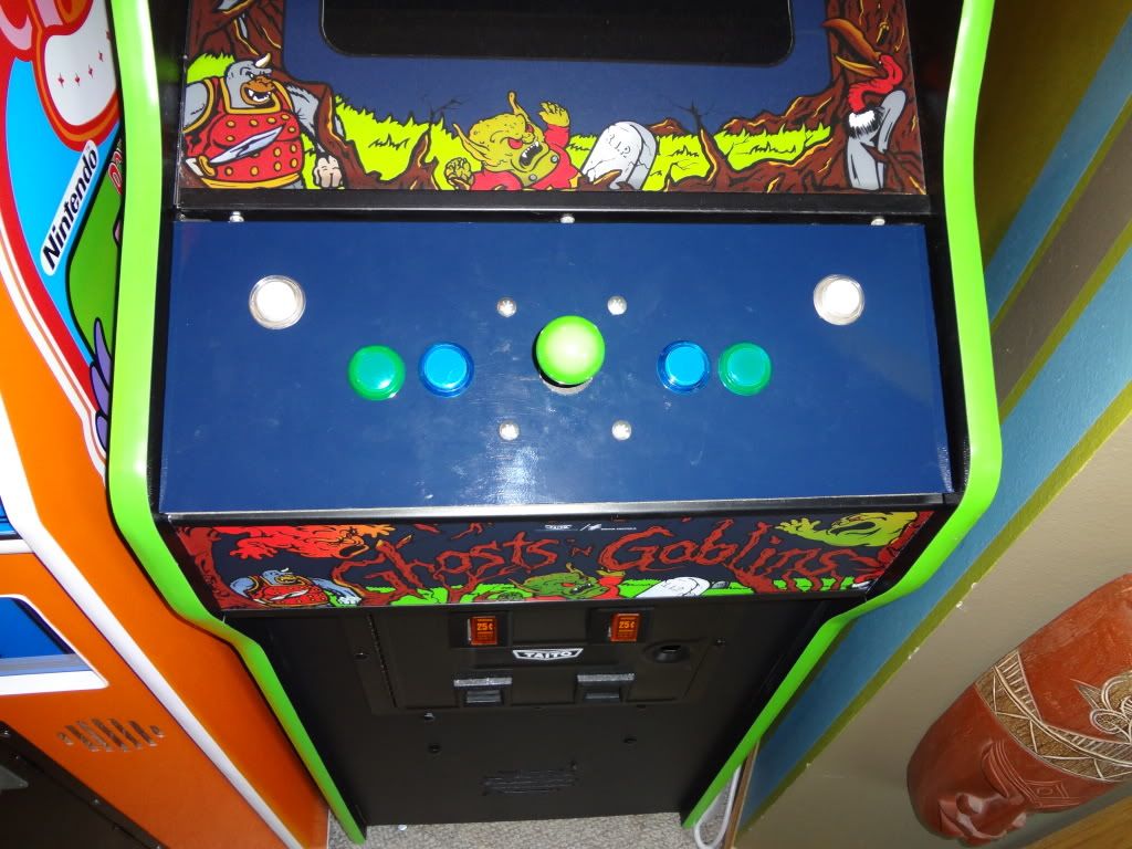

Now that I completed the CPO & decal set.:

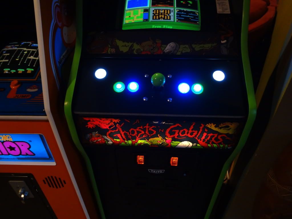

here is a picture of my dedicated GnG cab...
As taken from my blog www.guscade.com:
"The game was distributed by Taito America, as well as Romstar. The game was distributed in two ways; sold as a kit with a generic romstar overlay, button stickers, pcb, marquee... However some did come in dedicated purple Taito cabinets."
