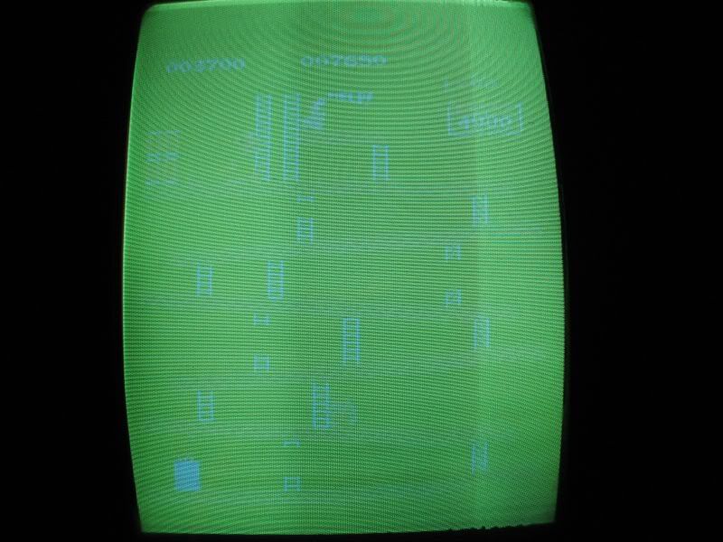

Ok the white screen is back !
Last time I unplugged the white video cable from the game board to the monitor and the picture came back perfect . I moved the cab today , turned on the game and the white screen is back , except ... I can see the outline of the game and able to play it but the picture is all white . I messed with the cables again but it didn't fix it . Could there be cold solder joints at the pins on the monitor board where that cable plugs in ?
Try adjusting your brightness?
Heres what it looks like with the brightness turned all the way down , screen turns kinda green . I've also tried using a different white video cable and no difference .

Just remembered what causes this, and it is one of two things. Either your video cable is bad or the ground pins on your video headers are not making good contact.
Reflow the video header pins on the chassis first and try it again. If that doesn't fix it, replace the video cable and try it again.

I've tried a different video cable already and it didn't fix it , so it must be the video header pins on the chassis . I'll reflow solder there and see what happens .
