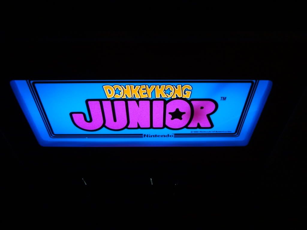

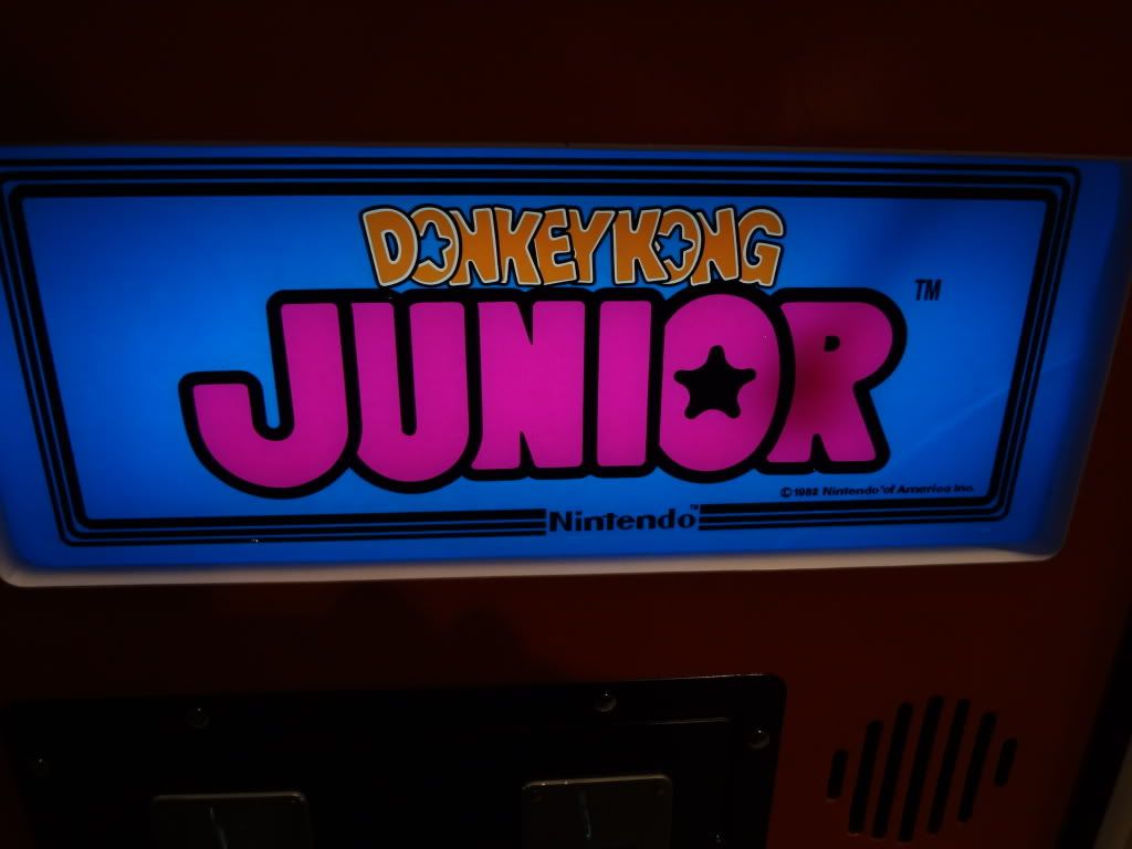

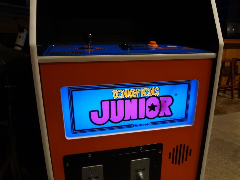

To your second question, yes, you can add a white layer to help diffuse the light for repro marquees. Frosted window film works, and I am sure regular old adhesive backed white vinyl would as well. I used 2 pieces of plexi for min, one clear for the front, and one white for the back. It worked well:
