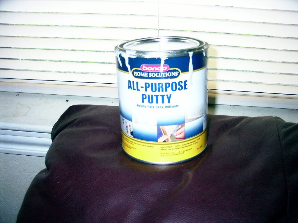

None of the above. I'm not fixing holes in cars or metal control panels. I'm fixing broken or missing wood. So I use this - found at any Lowes or Home Depot, and it works just fine...
Any of the stuff posted above will work just fine.:rolleyes:
Me too usually but I have a more major repair to do which will take a little wear and tear (base of the cab) AND I need to fill some drilled holes in a coin door so I will go with Bondo unless I can find the other pro stuff mentioned above.

I'm gonna guess you've never used a good quality body filler instead of wood putty :) Night and day.
Well, this IS Bondo Wood Filler, and not just some common wood putty.
I'm sure there's always a better-made product out there that can give me a quicker, faster, easier result, but usually my wallet says, "The cheap stuff works, so buy that." So I have to sand it for 25 minutes instead of 20, or I have to go back and touch up some air bubbles. I still get a good result when I'm done, and spent less than $20 to do so.
