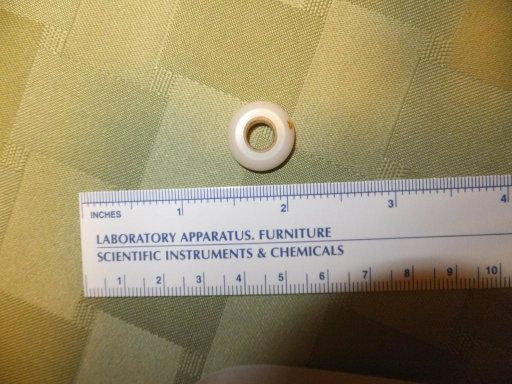

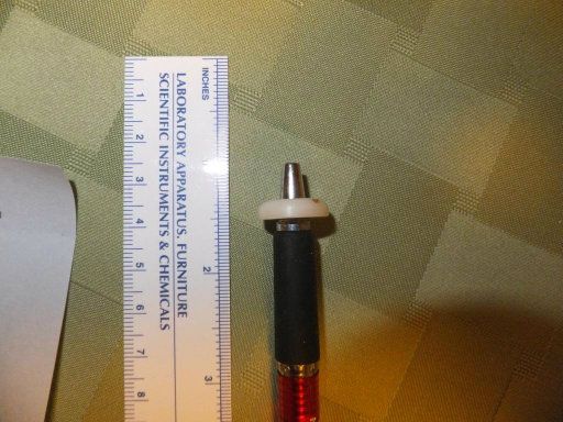

So, I finally figured out why my UDOT spinner was so sloppy, it's missing 2 small bits of plastic. I tried both Home Depot and Lowe's and neither had anything that would have been a direct fit. I'm pretty sure the second one is either a type of sleeve bearing or a simple nylon spacer, not sure if one would perform better than the other. The first one though, I haven't been able to identify, so I don't know where to find it. I figured it just might be some type of washer or thrust bearing, but I can't find one of either of those to match the dimensions. It looks like the roller on a sliding door, but all the ones I saw had a nut pressed into the center to secure with a screw, and they weren't even the correct dimensions.
Part 1 (Nylon thrust bearing?)
inner diameter ~ 1/4"
outer diameter 5/8"
height ~ 3/16"

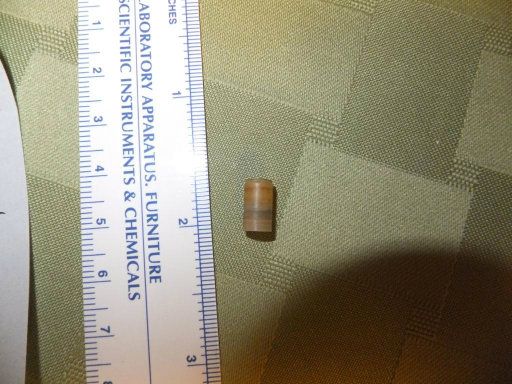

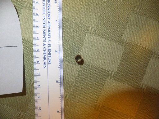

Part 2 (Nylon sleeve/spacer?)
inner diam. ~ 3/16"
outer diam. ~ 1/4"
length 3/8"
I did find a place online that had a listing for a similar sized spacer, but I want to see if I can find a site that has both pieces.
The top one looks like a screw bezel or a standoff, which should be availble at Ace Hardware. Do a google search for them - you'll find them.
The other one looks like it is the same nylon material as a coil sleeve. I'd suggest looking up nylon tubing and see if you can find it. If it is metric, I may have a line on some from some soccer field line sprayers. You are basically looking for very thin wall nylon tubing. Search for Nylon Bushing - you'll need the wall thickness and OD to get the right one.

I went to ACE today and didn't come up with any exact matches. I did find that a Slide-Co roller (item # 163582) for a bifold door can be used in place of the upper leaf switch actuator (piece in top pics). It has the same ID and a close OD, but has to be sanded down to the proper thickness. It looks like I was a bit too liberal in my measurements of the nylon spacer though. The ID is actually for a #8 screw (0.17"), but the OD is 0.217". I bought a 1/4" one and tried sanding it down but the heat and pressure from the belt sander warped one end and it wouldn't slide freely. I looked all over the net but couldn't find one with those specs. The slot in the spinner is only 0.222", so no way a 1/4" OD will do. With a wall thickness of < 1/16", Bally must have either custom manufactured these or they somehow sanded a bunch of 1/4" spacers down.
