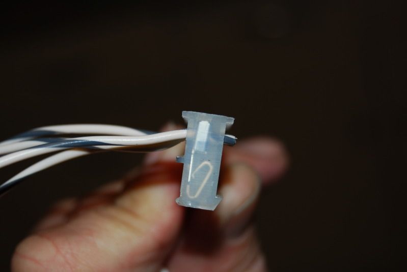

Whats the proper punch down tool for this connector?
Was wondering - does anyone know whats the easiest way to "punch down" wires into this style connector?
picture.php
Trying a little screwdriver kinda sucks - was just wondering if anyone knows of the "proper" tool for these?
Thanks!
Looks pretty similar to a phone punch down panel. Maybe this impact tool will work? I can test it out tomorrow.
Thanks Tombo!
I was looking at something similar to that - figured id ask before I ruin a good connector.

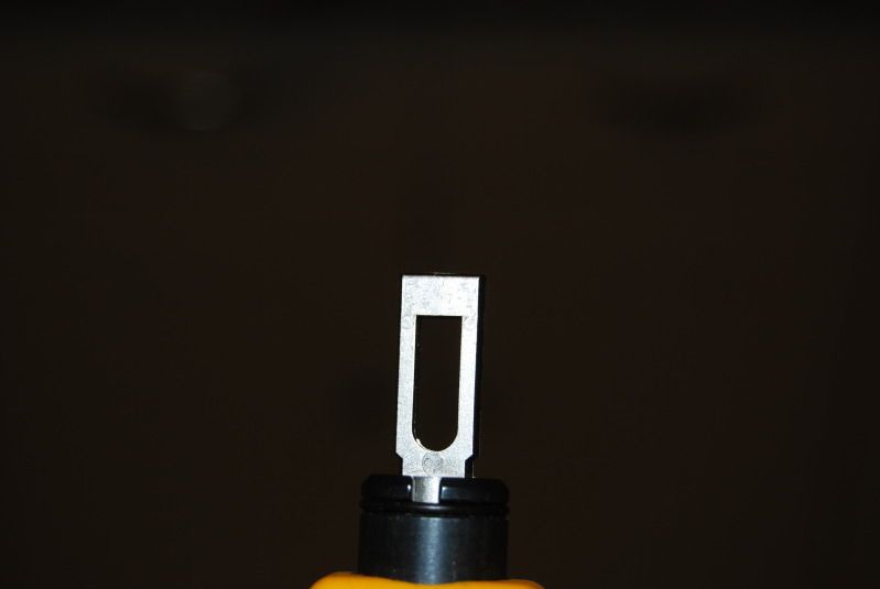

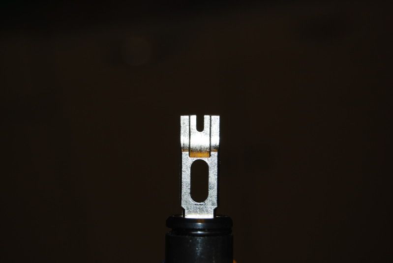

I totally forgot to test this out. It seemed to do a decent job of ramming the wire into the metal. I slipped and impacted my finger to boot! I think the blood can be seen on one of the pics, lol
I used the side of the 110 bit without the knife (good thing too as it would have probably hit my finger bone!
For reference, this is the 66 type bit without the knife

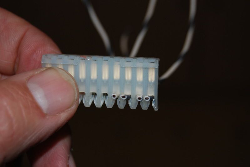

If, for some incomprehensible reason, one must re-use an IDC connector rather than yanking the pins and replacing with crimp-on terminals....
The proper tools are sold on the GPE website. Not sure if the OP is interested in 0.100" or 0.156" pitch, but Ed has both tools available:
http://www.greatplainselectronics.com/Category-140.asp
