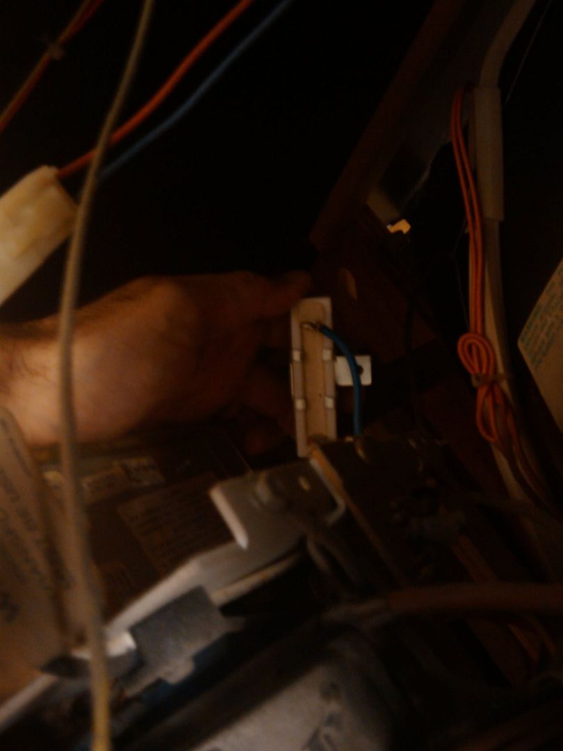

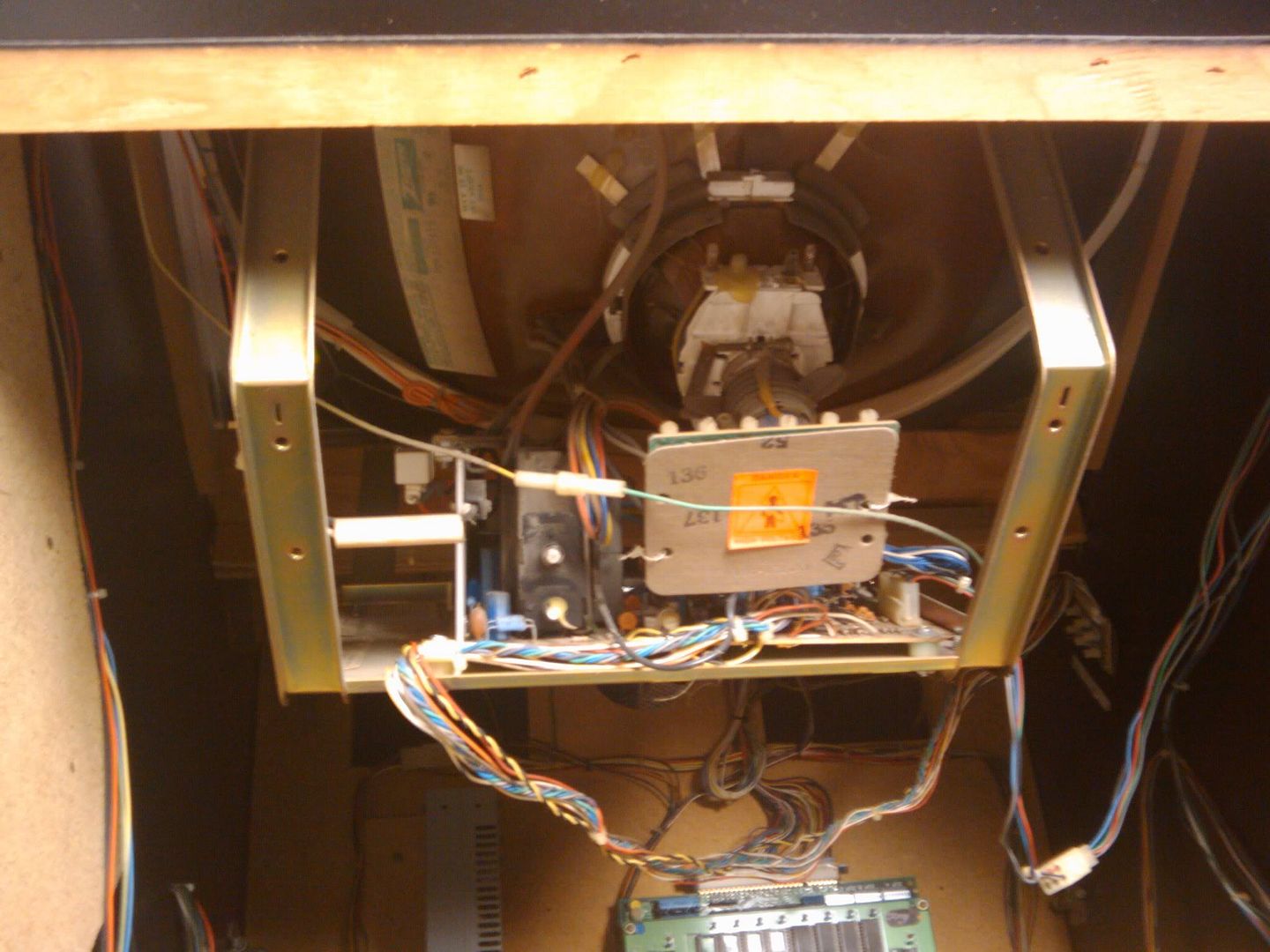

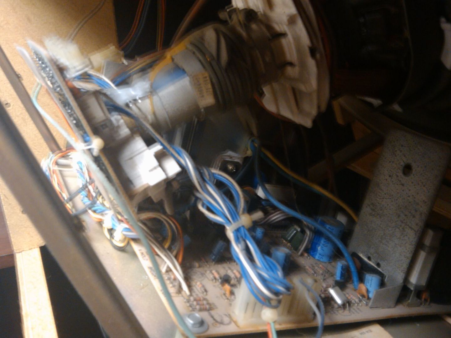

OK, its a K7191. Here are a couple pics: (sorry, cell phone pics)
ceramic fuse?
http://i69.photobucket.com/albums/i45/clintziegler/d7f92fee.jpg
That's a resistor. It usually has a nut and bolt securing it to the chassis. I don't know why it's turned up like that. Your flyback is the white knob type which should be replaced. I foresee a Bob Roberts chassis rebuild kit in your future.
If that white square ceramic resistor is what you believed to be the fuse it's not. The fuse is on the opposite end of the chassis from the flyback.
Thank you. I *thought* it looked too much like the ballast resistor on my old dodge. :)
I only unbolted it for the picture, it is now secured back in place.

CHASSIS FUSE BLOWN??? Check the hot(horizontal output transistor) ohm in between the center and third pin... if you read anywhere near 0 ohms, its shorted.(pull; and retest to make sure) If the hot is shorted, theres a reason it failed... usually a flyback failure. In this case replace the flyback, hot,fuse, and VOLTAGE REGULATOR. WHen the hot fails, if usually takes out the voltage regulator too. There is also a saftey cap, c36, that will sometimes short out, especially if youve had a hot of flyback failure.. Ohm it out one meter lead at each end.(if you have the 4 legged cap this test still works, just pick one leg on each side) Replace this cap if shorted. I have also heard about the large diodes shorting out, but ive never seen it personally***STILL WORTH YOUR TIME TO CHECK THESE***
Bob Roberts chassis rebuild kit includes the fluback, caps and HOT. You might need to order the voltage regulator and C36 cap if yours tests bad.
