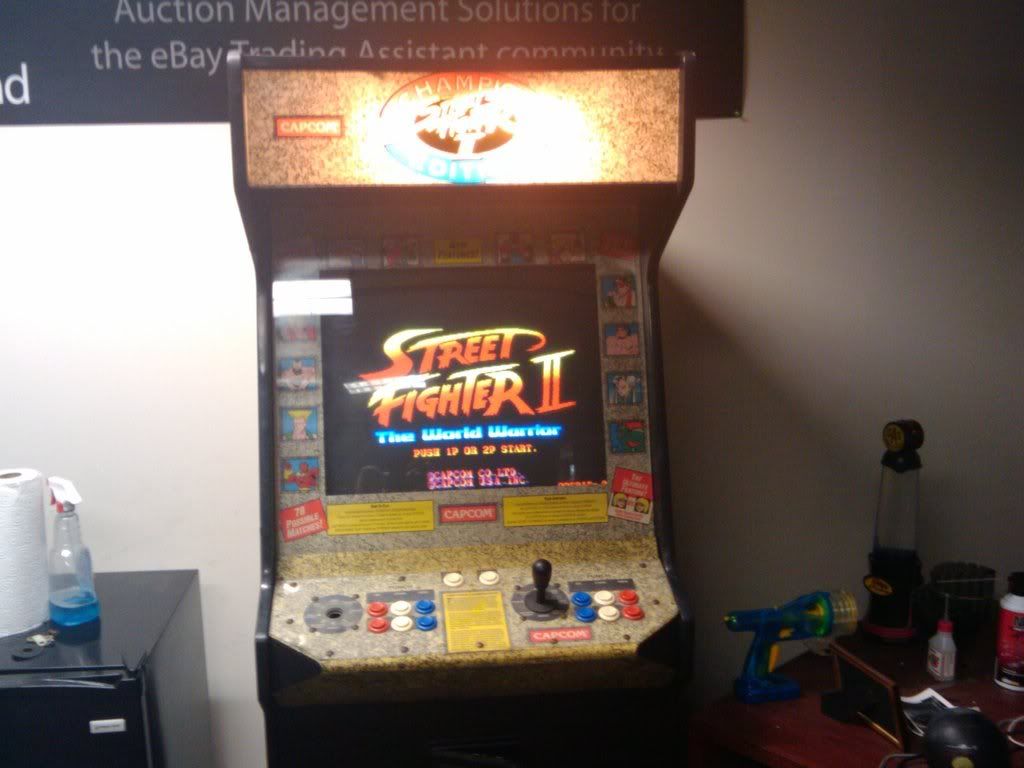

Not sure what the going rate for this is, Street Fighter 2 Championship Edition, dedicated cabinet, I don't know if it's an original cab there is no side art, just black.
Just needs 1 joystick and maybe a few buttons, going to try to clean up the contacts to see if they are salvageable.

Thats not a CE boardset. If it were it would say Champion Edition under the logo in that screenshot, not World Warrior which is the first SFII. Champion Edition also has boss characters selectable, WW does not.
So basically you'd need to change either the boardset or marquee to correct it whichever way.

Just piping in, hoping to add more info on some of this. Capcom has a really sketchy history when it comes to their dedicated machines during this time. World Warriors and Championship Editions at one time shipped in the generic dynamos. I don't know about them shipping in 25 inchers though. Hyper Fighting definitely started shipping in the red z-backs, which were 25 inch. Yet there is official CE bezel artwork that fits a 25 inch monitor...and a marquee that fits the "Big Blues" that didn't take off until Super SF2. In other words...it's a mess. Good luck.
It's also a World Warrior, which is damn near unplayable now days compared to CE or HF. It's also missing a stick. I'd offer $100 for it and see where things go. $200 and I'd start to pass.

It looks to me as a HS-5 which did ship pretty much dedicated and as a kit. It could be either... does it matter. It's the right CE CPO which is hard to find if it's not dedicated. Lots of CPS1 boards went dead or lost sound etc... I'm sure they swapped in the original SF2:WW board afterwards.

Thanks guys, I checked the wiring out and it all looks really good, no rats nest or anything like that. From what I am seeing, and knowing where this game came from I am leaning towards it being an original cab with a swapped in WW board (good eye welove80s, I don't know how I missed that). The monitor is very clear and bright, and I'm pretty sure its a 25".
We picked it up for $100 yesterday so it sounds like I did pretty decently, not a major score but I didn't get burned either. It does need some work on the controls to have it fully operational, but it will be very playable. The speed of play is no issue for me as I have been playing this game for nearly 20 years.
