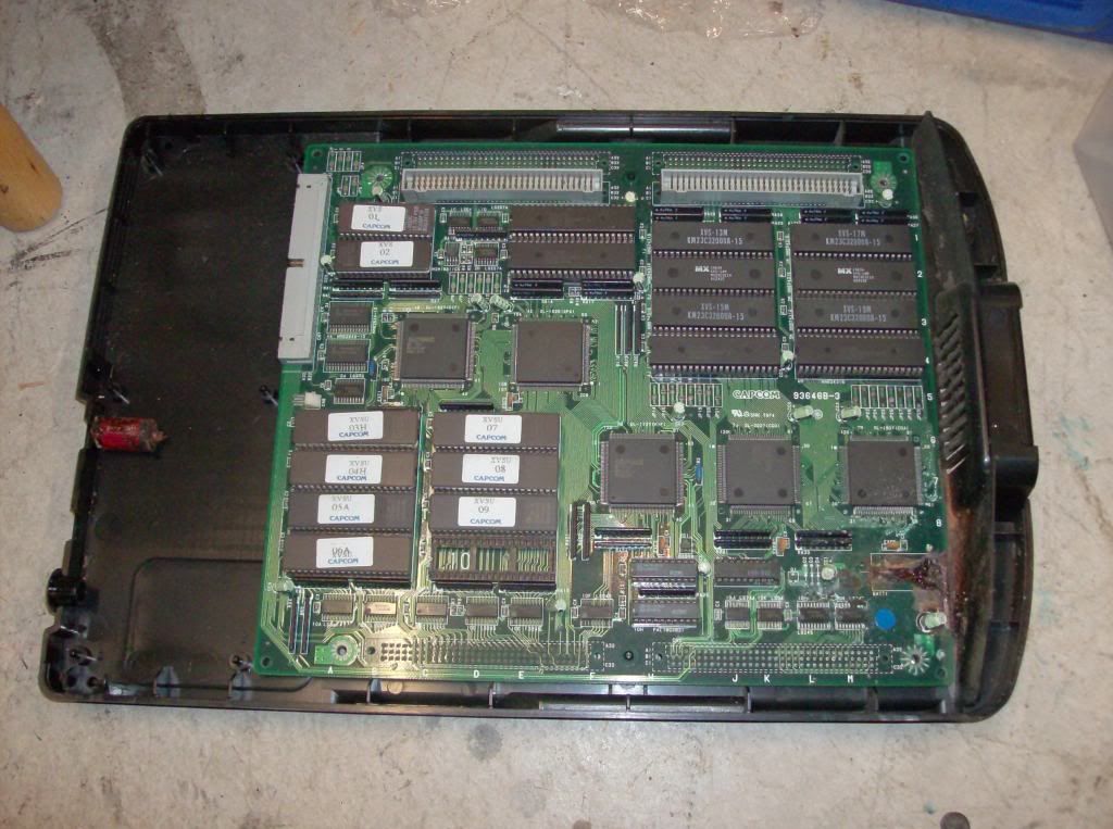

well before i started jamming on my games tonnight i thought id pop open the xmen vs streetfighter board that came im my most rescent venture
i asumed it had the dreaded sucide bat death as it came up to a green screen
welllll i was right but man this makes me scared to open up my darkstalkers board and xmen cota board
tick,tick tick booooooooooom
i know these boards are able to be pheonixed but dont the boards have to still be working
if not what do i need to do burn a set of chips without a ss checksum
can it be salvaged or should i just throw it in the garbage after stealing everything worth a dam off the board

Save the PAL chips, the graphics ROMs, and the sound/program EPROMs. Document the solder position of ALL the jumpers on the board. All of this information and the chips can be used to put that game on a different CPS2 cart board (It'll still need phoenxing though...)

That said...I would try to save that, doesn't look like the end of the world but it doesn't look fun either.

Actually, this is the reason why you should open ALL of your cps2 games. This battery has been dead for years to have that damage. A battery that has begun leaking recently can be easily removed and the pcb can be cleaned and neutralized. If you see the battery getting "fuzzy" on the ends, change or remove it.
Definitely replace CPS2 batteries when you get boards in - it's the easiest solder job you'll ever do, having the piece of mind that they are safe for 4 more years makes them much more enjoyable.
You could try rehabbing it. Soak it in a mild vinager solution and scrub it with an old toothbrush. Then rinse and dry for a couple of days.

I could probably fix that. I deal with boards in that condition on a daily basis at work. I repaired a punch out board with leakage from 3 AA batteries and it was in much worse shape then this.
