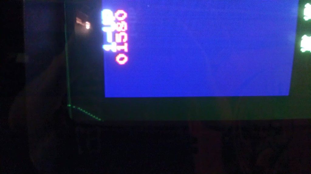

squall280 Active member VAPS Joined Mar 19, 2010 Messages 1,382 Reaction score 19 Location Pennsylvania Jun 18, 2012 #1 bottom let has a little line. doesn;t affect gameplay but wondering if its fixable and what would cause this.
modessitt Volunteer: Encyclopedia Submission Moderator VAPS Joined Mar 22, 2007 Messages 33,414 Reaction score 325 Location Austin, Texas Jun 18, 2012 #2 Depends on the chassis model. But it looks like a little bit of "curling" that you sometimes see on some models when the hold or b+ isn't adjusted quite right...
modessitt Volunteer: Encyclopedia Submission Moderator VAPS Joined Mar 22, 2007 Messages 33,414 Reaction score 325 Location Austin, Texas Jun 18, 2012 #3 Oh, and your green is up too high...
Buffett Well-known member Donor 2012-2013 VAPS Joined Mar 12, 2010 Messages 10,991 Reaction score 263 Location Manassas va, Virginia Jun 19, 2012 #4 or it could be your H-Hold is off slightly but not enough to mess the rest of the pic up. Peace Buffett
