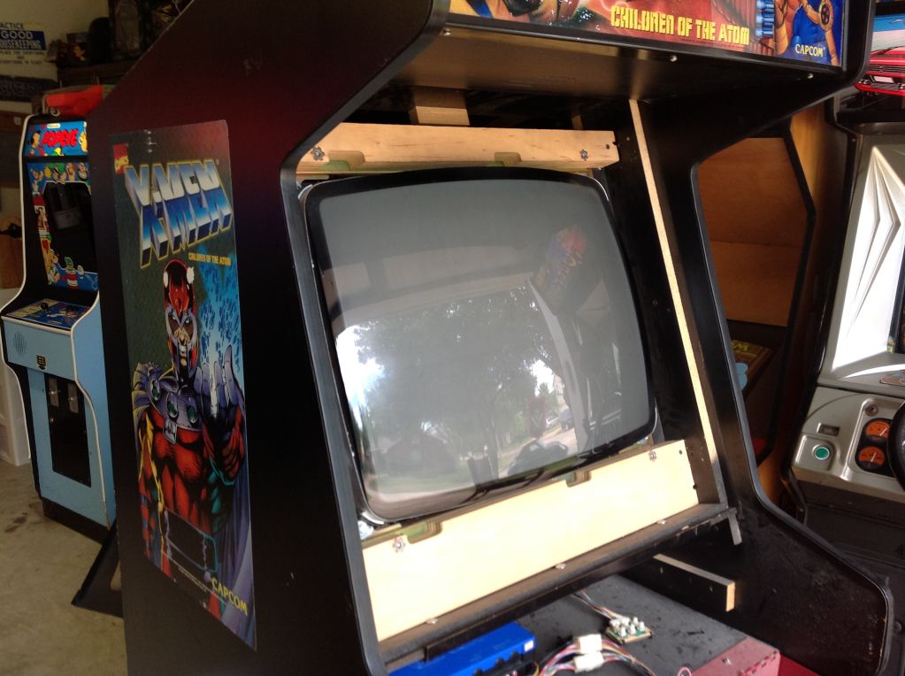

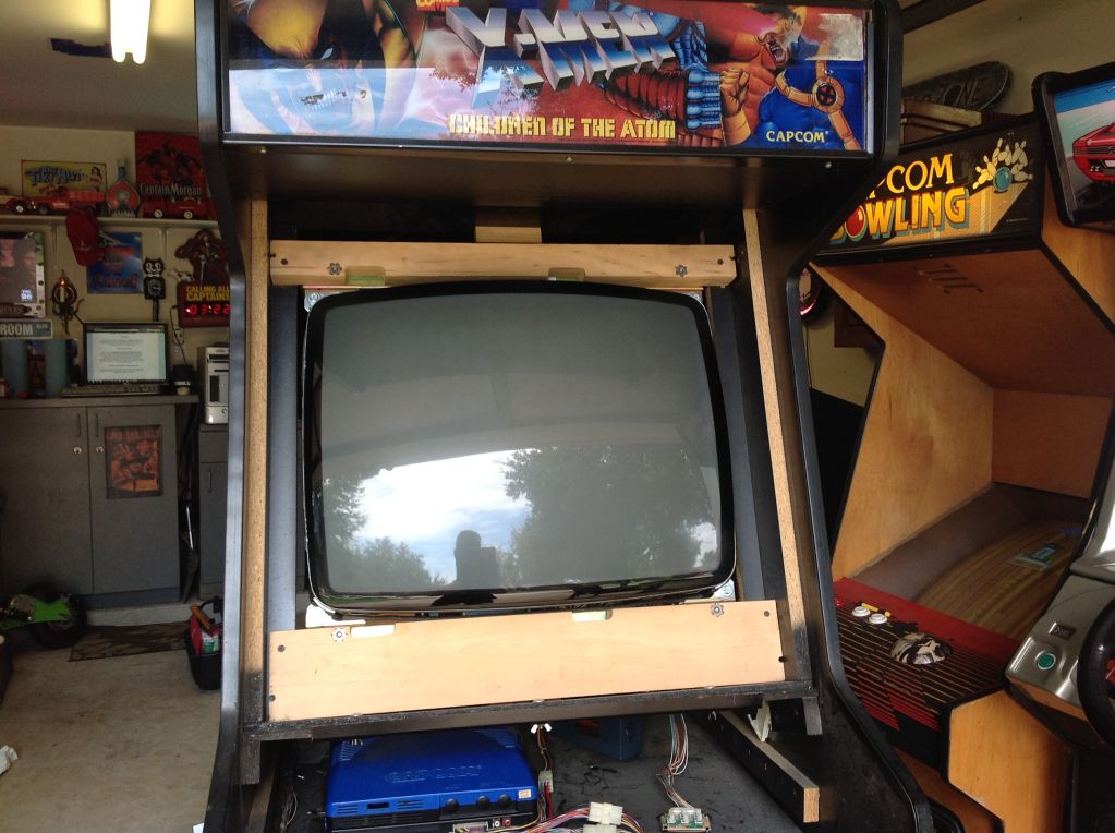

What will happen if i place a widescreen lcd in this game?? plz help...It is xmen children of Atom..will it display ok? thanks and it is 25 inch monitor.
My monitor has tube issues, and im trying to save money. Thanks in advance.
Well you could probably source a 25" replacement tube cheaper than the video converter you would need in order to use the widescreen lcd.
so i already have a video convertor and i really dont want to go on an endless search of tvs. Ive already spent 125.00 on a chassis. I just want to fix it as soon as possible.
A widescreen LCD will look like shit. If you've already spent $125 on a chassis, why not get it up & running? Sourcing a suitable tube shouldn't be difficult.

Do not do it. It will look terrible. Even the ones for arcade games look terrible. You will regret it, most do. It also instantly brings down the value of your game. What is your monitor? If it is something common like a K7000, those zenith tubes are all over the place.

Ummmm, what does tube issues mean? Since you have a different chassis, have you tried a rejuvenation?
if you look at the pics it is a K7000 you can see the remote board.
get that tube checked they go bad but a good rejuvenation can bring it back to life.
