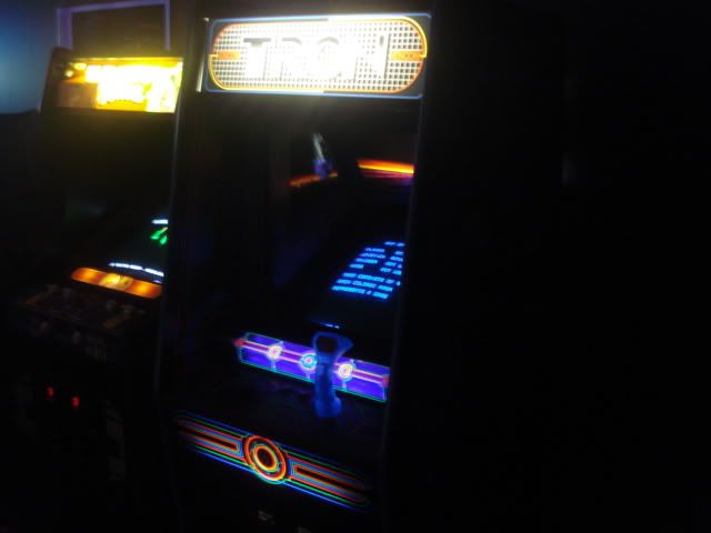

Great news tonight - its alive!
As noted last night, had some problems with a non working monitor (had glow but no picture).
Figured it needed reflowed solder so came home tonight and tried that - made progress as switching her on revealed a Blue line right down the center. Did a search here and saw that Modessitt and Dokert had similar issue before - very happy to have a reference and starting point (WG4900 vertical collapse). Quickly pulled the chassis again and reflowed solder in suggested areas - plugged it back in and same issue. Posted in the monitor section, and both guys quickly responded - suggested another go around. This time i reflowed pretty much everything.
Plugged her in and it worked! Thanks guys. Needed some adjustments to get it stable, and will need more tomorrow, but i can end the day knowing it works. :) Very rewarding experience. AND i may not need to adjust convergence (woo hoo!)
P.S - if anyone can suggest a lead on what the thin white lines are on the right side of the monitor and how to get rid of them - thanks in advance.

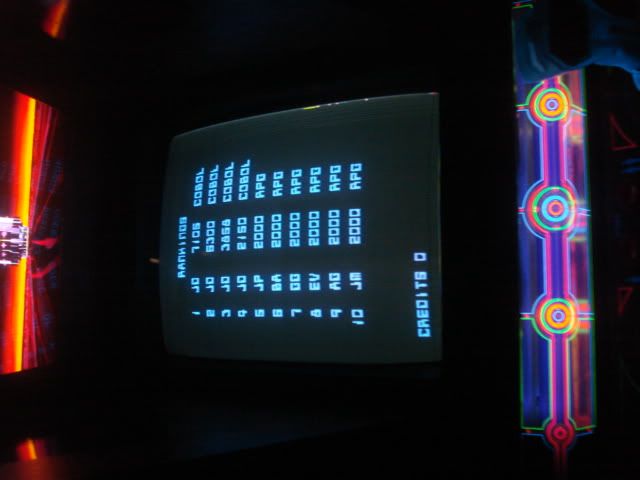

Sweet! But it can't be good for the game to have it sitting on it's side like that.
:) i know, i know. As Phet pointed out to me earlier sometimes my pics look like some sleazy CL seller posted them (that might be me).
I keep forgetting my camera should not be tilted "landscape" (or needs to be put into landscape mode). Especially last night - i was pretty amped up after seeing a working game and just tilted and clicked away.
tonight, i need to make a few screen adjustments and should get the ideal pic (hopefully).
I'm guessing you may need to turn down brightness or adjust horiz position / size to get rid of the with line on the right.
I had a simular problem with my ST:Voyager and ended up turning down the brightness on the HV section
The white lines/garbage on the right side of the screen is standard on MCR games. Satan's Hollow has it too. I think Journey and Spy Hunter may have that as well.
The white lines/garbage on the right side of the screen is standard on certain Midway/MCR games. Satan's Hollow has it too, possibly Journey and Spy Hunter as well.
I didnt spend too much time adjusting it last night - just happy enough to have a pic!
The white lines - in my pics there are two types -
-- Far right has really pronounced white garbage - Had the same thing on my Spy hunter - but running on the bottom of the pic. Tried every adjustment before getting a Horiz cap kit to adjust it out. On this Tron - I think a vert shift should eradicate it (hoping).
-- For the other lines (thin white lines) modessitt suggest vert dampening adjust - again hoping that works.

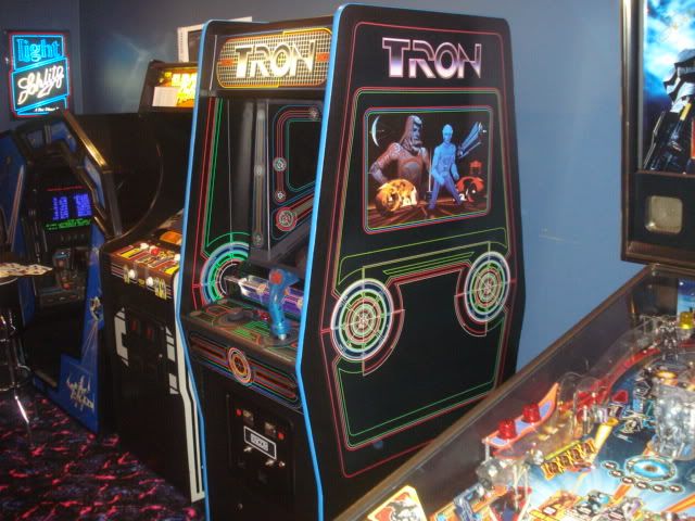

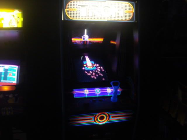

Monitor all adjusted, thats it - Tron lives!
I also put in an Encom Marquee and Sticker - many thanks to Bob5150.
One final problem i have - game is not saving high scores (and i have an arcade shop MCR kit in there too!). Will look into it tomorrow.
