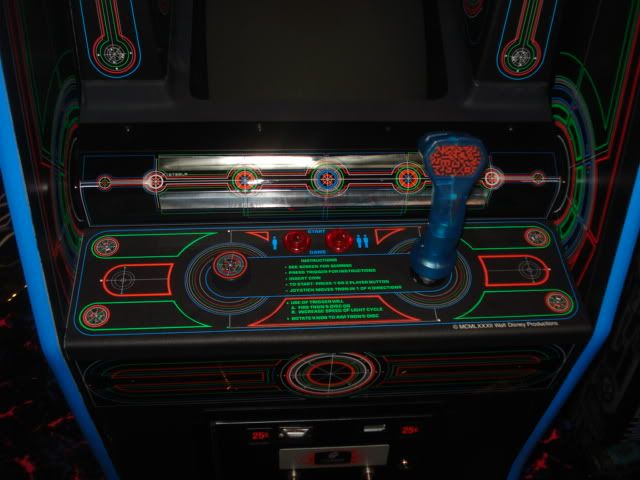

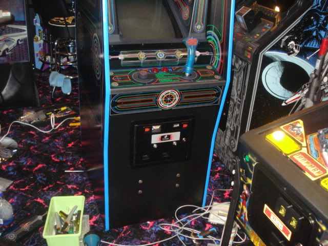

Got most of the front hardware on, and assembled the coin door.

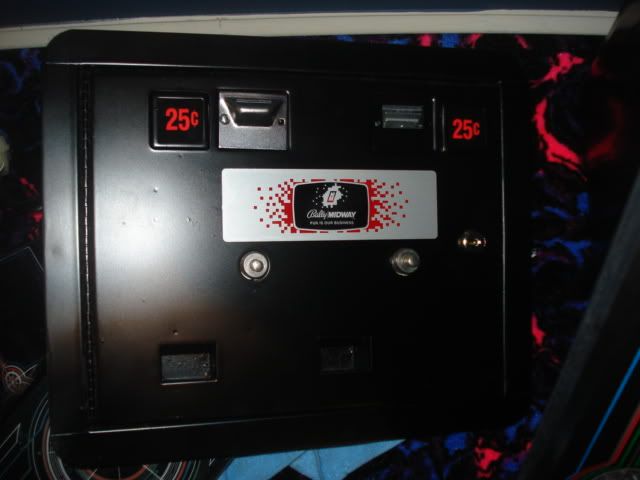

Coin door issue - i lost three small bolts that mount the coin slots to the front - need to order them. Otherwise, i like how the paint job came out (just satin black) and the new Midway adhesive logo from Arcade shop.

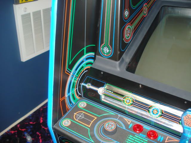

Please note the shroud is painted flat black (only had Krlyon plastic spray paint on hand, flat). I think it looks ok - let me know what you think.

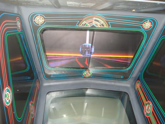

Was going to mount the marquee, but had an issue fitting it need to find out why (maybe i have the trims reversed). Other than that, besides being time consuming, it went ok.
All the pieces that fit into the front (CP, Metal bars, shroud) are VERY tight fits and leads to alot of nervous moments since i dont want to scratch up the sides. See if you can catch a few scratches as a result in the pics. Oh well, nothing major.

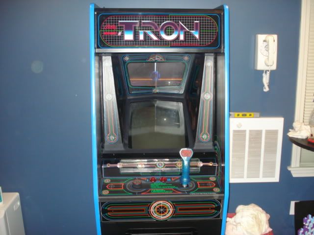

Quick update - machine is all together now (just need to put locks on the back).
-- Replaced Coin slot bolts with some bolts i had laying around - cut them to size.
-- Have the machine working now! Thanks to Arcade shop adapter, i have lights, monitor turns on, 5, -5 and 12 volts (nearly 12 - 11.75 or so). Great news considering the cab was not working when i got it.
-- CDJump checked my boards and made some ROM fixes - happy to know the board is on its way. Thanks Chris!
-- Three front lights work fine, back landscape light doesnt work. It Is getting AC, so, need to troubleshoot it tomorrow. I replaced the starter already, so its either the light fixture clip or the ballast. I have spares on hand, so will just replace them.
-- I Reported that the spinner was binding - no visible sticking points. I oiled it with 3 in 1, spinner is SMOOTH now. Cant wait to get Tron flailing!

are you missing a coin slot on the right? Where would you get replacement parts for something like that?
Nice and shiny
hope to see some pics of the game working
Yes - i was missing the slot in the phots - I had the slot but lost three of the small bolts. I am sure they will turn up. Corrected it last night - had some #6-32 bolts, cut them down to 1/4 (or so) and put them in.

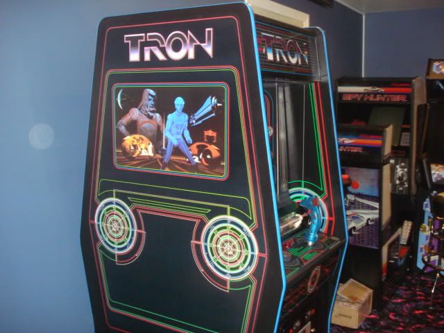

Latest update:

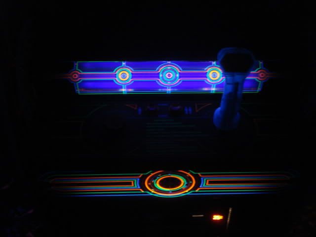

-- Cosmetically game is done!!! (with exception to an Encom marquee i plan to put on in a few days).
-- Electronics - game is lit up (rebuilt the back marquee completely and now works), voltages correct all around, monitor seems to be running, just waiting on boards back from CD Jump and then i may be able to actually play Tron!! As noted in past posts, i do expect purity / convergence issues :(

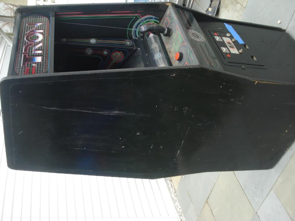

Received condition:
Latest pics:

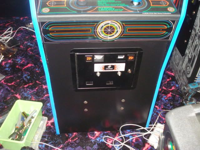

Oh yeah - notice the left coin door slot is out? I notice on Arcade shop power supplies the Coin door lights burn out QUICKLY. Anyone have this experience? I have the same issue on my Spy hunter cockpit.
have you checked the voltage bulbs that are in there? if they burn really bright and then die you have lower voltage bulbs in there. you should be using #194 12v lamps in there.
Awesome man!! That looks sweet! Yeah, you're using 5/6V bulbs (44's or 47's) and they should be 12V (194's or 1813's). That's not Anthony's fault LMAO SMOC!

The bulbs - coincidentally as soon as i posted yesterday about them i saw this thread going on: http://forums.arcade-museum.com/showthread.php?t=182258&highlight=#194.
Yes- i am using 555s in there (on both my SH and this Tron, wedge base). My wifes dad has an auto parts business, so she is scoring me the 194s and 161s (lower wattage). That should fix both cabs.

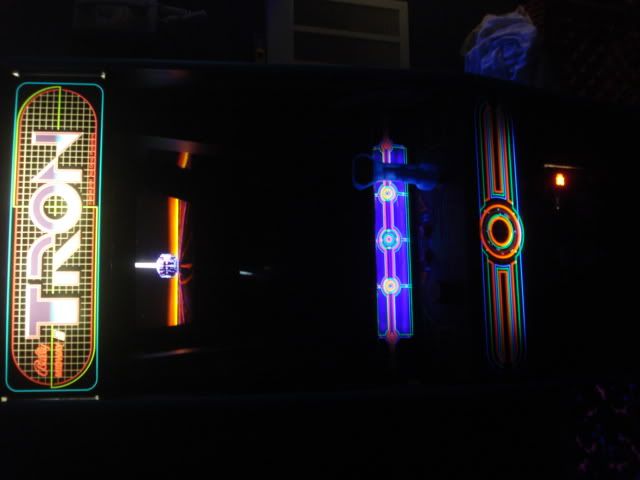

Todays update. Got the boards back from CD Jump - very, extremely fast turnaround. Game had a ROM issue, so it was a good service.

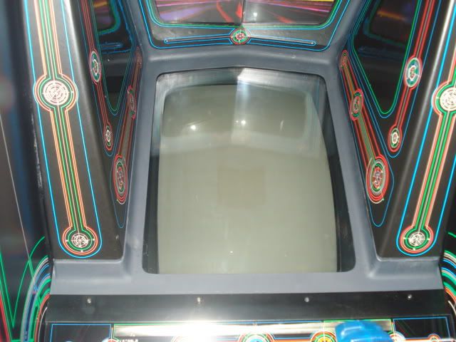

Swapped in new ribbon cables - game wouldnt start - turns out one of the cables i put in incorrectly / off a row. Game plays blind now - as expected, this monitor is going to drive me nuts.
I get a neck glow, but no picture. Learning as much as i can on WG4900 series (the monitor says WG423268 or something like that). Any advice? I know i first need to check B+ but nowhere, not even in the manuals does it explain where to check that!
Wish i had a G07 in this cab....... any advice is appreciated.
