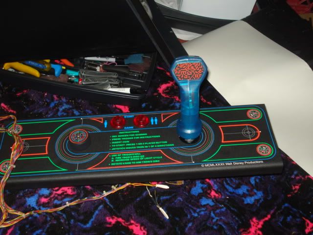

-- Cp put together. Took me three hours - dont ask me why just struggled with it or i just took my time. Finally got it assembled. Came out nice - besides using Groovy Game gear Tron Joystick - which is incredible and well made i cant wait to use it, i also put in a Satans hollow insert (red checkered pattern). I have the Tron insert from the Phoenix artwork package, but just like the Red checkered pattern.

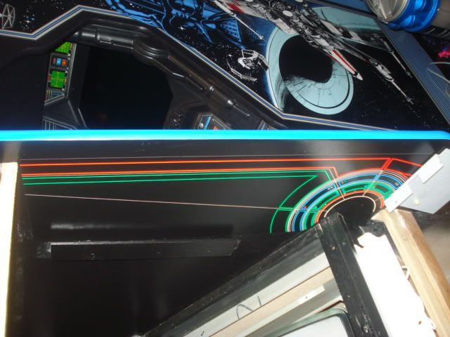

-- Side art on!! Big step. Did it wet and alone (that sounds bad).
I didnt sweat - when a decal job goes poorly, common symptom is LOTS OF SWEAT (ive had it happen before). This time i was smart - when peeling the sideart, i sprayed it with soapy water as it came off the backing. This way, if one side touched the other, i didnt ruin the art.
Its amazing how much room for error you are allowed when using the wet method - lots of time to adjust, peel back up, correct height and bubbles. Overall, i am very happy with the results.
Also, another mistake i made - applying in 80 degree weather / direct sunlight. The wet stuff (soapy water) was gone within a minute of spraying - therefore, didnt have much time to adjust. Again, managed to pull it off, and pretty happy with it.

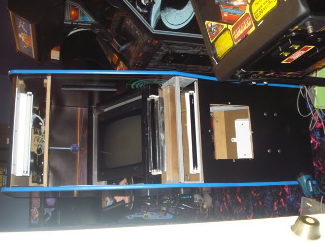

Going to take the night off (i will try!). Tomorrow, plan to assemble the coin door and start putting parts back in.
Inner shroud art will go on last after i have the cab together.

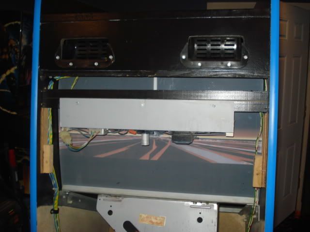

hope you take pics of the wiring harness stuff and how it connects to the boards.
I need to find out about making up new harness or finding some.

http://s663.photobucket.com/albums/uu352/jonathan1138/Tron Harness/
That link i just put together - it only contains pics i took of the harness routing around the cab before the teardown - i will use it myself when i start assembling everything this week (its a different link than the restore link, which i only post progress pics to). Hoping you find it helpful.
Tearing down goes fast (its been a week now), but putting it all back together - that takes more time. When i complete the effort, i can certainly upload detailed pics of the final version - should be much nicer for your task since there wont be filth on the wires.

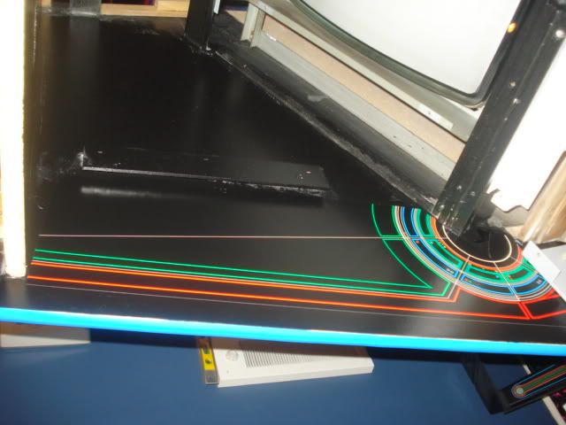

-- Shroud inner art applied. First, a huge thank you / appreciation for Phoenix Arcades product. The Tron art work package is now fully applied, and i must say they make a quality product - the best repro i have seen. Absolutely gorgeous and quality work.
Second, laying art work is EASY now that i have done it a few times - with the wet method. Anyone with fears of application / messing it up just has to realize that with a spray bottle of soapy water, liberal (reasonable amounts) sprayed on the back of the art and to the source, chances of foul up are very slim. The Adhesive used will set immediately upon water dry - its pretty hi tech and cool stuff.
As for the art - oh boy. The inner art needs to be trimmed to fit, centered with the blacklight housing. I failed arts and crafts in school. That factor led to a less than ideal job - but i think i am being too hard on myself. Both sides match up, the only issue is it might be a inch or so higher than it should be.
How did i cut it? Lots of advice to online to lay paper / make a template / cut across the template. I said NO to that and just free formed it, inching it in, cutting, inching it in, cutting (the need for template / cut is due to angles around monitor and CP mount pieces which are unremovable).

Two other latest pics of the Sideart applied.
Now you need to stop masquerading as a bottom feeding CL seller and at least rotate the pics. *sigh* Also, use the tags, don't attach them.

Here are pics of the Side art i did last night though. Looking at it again, i think it came out ok.
Cab starting to go back together. Maybe by Friday it will be completely assembled.
No real issues. Not looking forward to putting on that front light cover - its tight under the mounted lower blacklight, i need to squeeze some nutz in there (thats we she said!)
