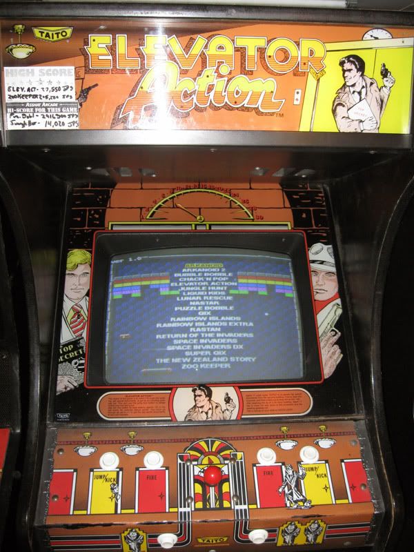

Yeah I used an orbital sander locked and loaded with 40 grit sand paper. After the 40 I used 80, then 120, then 220. I used a 2 foot square to reach plumb and then used Minnwax wood hardener to seal the deal.

I always gut my cabs before restoring them, you really should to make sure everything is clean anyway. Lots of nooks and crannies that can hold dust, shit, coins, urine, ciggy butts, dead things, you name it. With the Taitos, I leave the top bolts in to hold the cab together, but remove all others.
