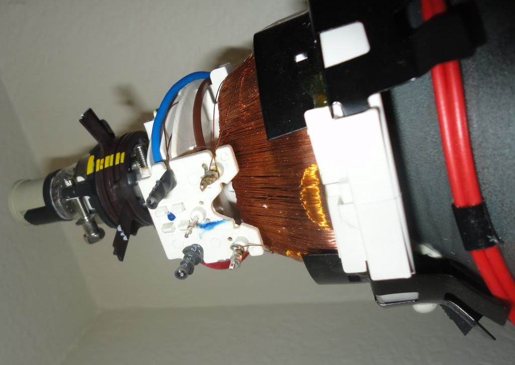

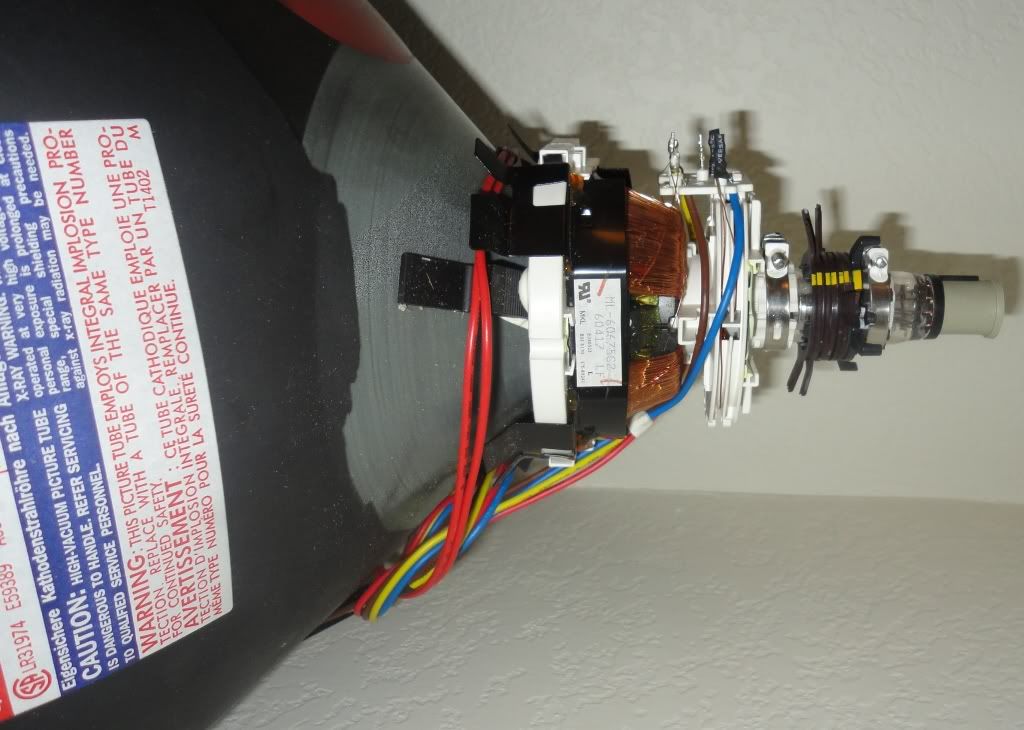

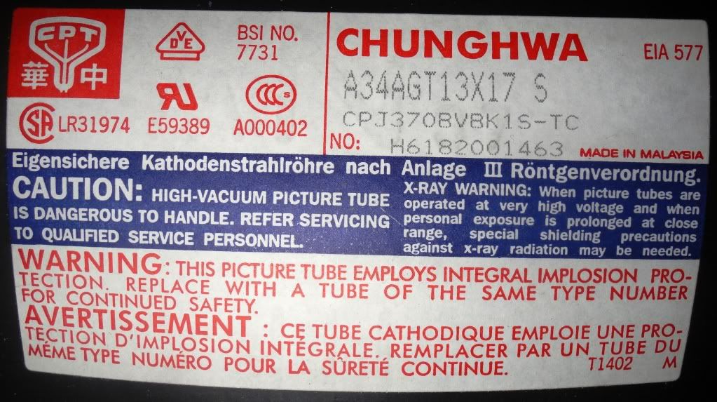

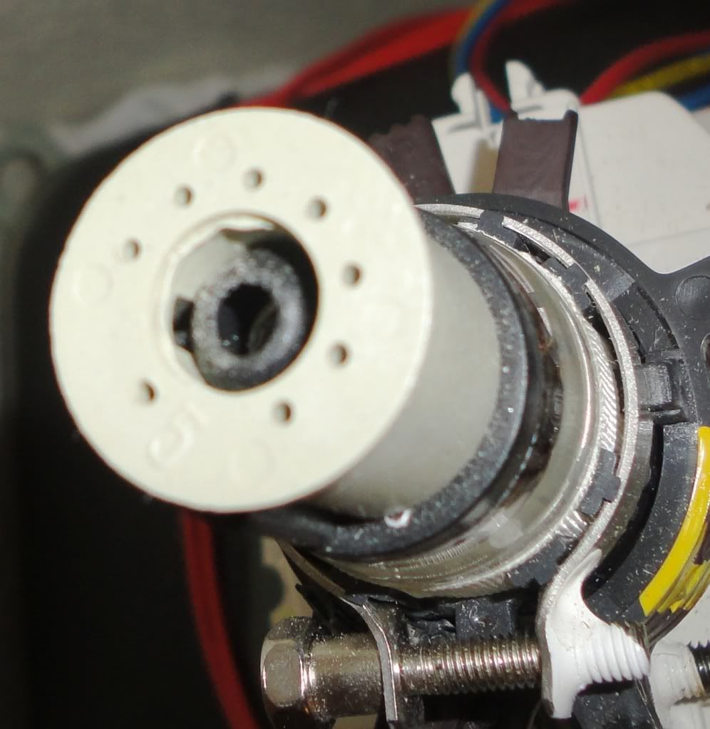

Got a 13" tube that is NOS and I need to know what monitor set-up this goes to. I've been searching the internet and getting no results. 8 pins and the following label...
It's really not that simple. Is there a yoke attached? If not then that tube will work with the 4700, 4800, some K7000s, and possibly others...
That's not going to be an easy one to find a chassis for. Every 13" arcade monitor I've seen was a CR23 tube. A WG7000 is the only chassis that comes to mind to use with that.
I've seen later era Wells-Gardner monitors (7203 series) use Chunghwa tubes. These were 19"ers though. What's the yoke connector look like? TV tubes usually have a different style of connector than amusement monitors.

I contacted JOMAC at http://www.jomac.net.au/index.htm and they informed me that this tube needs a Kortek KTM-F14 chassis and that my readings are a bit off (first time using the digital multimeter so I should have expected that). Anyways, now I just need to find a very nice, rebuilt chassis for this new tube and a frame...but it will have to wait until I have funds (the story of everyone's life).
