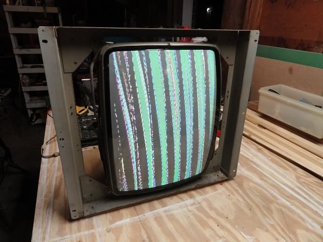

Purchased a parts cab for it's monitor to replace the dead one in my ms pac cab and am unsure what is going on with it. Occasionally I plug it in and it displays the picture just fine...other times(most of the time) it displays the "lightning bolt" picture as seen below. I have tried adjusting the Horizontal Hold which does nothing to correct the picture.
What happens most of the time when powering it up:
Working after turning off and on several times:

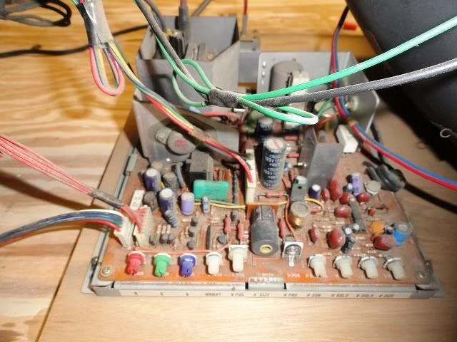

Control board:
Anyone have any ideas? Also, the only markings on this monitor are in japanese so I am unsure what model it is...
Order yourself a cap kit from Bob Roberts. Guy has fair prices and generally has anything you need to fix a monitor with lol.

Don't know how you're going to order a cap kit without knowing the exact model. I just listed the manufacturer it most resembles.
You may need to just make your own cap list...
Yeah...I'll likely make that a weekend project one of these weekends. The thing has a ton of capacitors so I imagine I'll be busy on this one :)
For anyone who may stumble across this post in the future searching for a similar problem, I wanted to post an update...
Even after a cap kit, I had the same issue with the lightning bolt effect...The solution to my problem was replacing the Horizontal Hold potentiometer.
Also...I finally identified this monitor as a Sanwa PM1718. Schematics can be found in the Boomer Rangr manual as found at: http://www.crazykong.com/manuals/BoomerRangr.man.pdf
