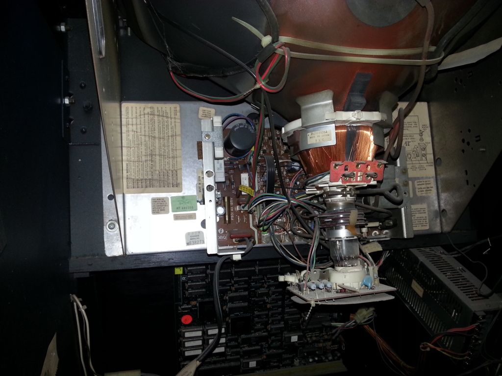

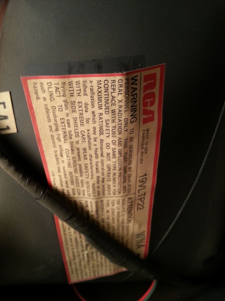

I've been debating whether or not to get rid of Rastan Saga and put a Track and Field back where it originally was. The monitor seems to work fine, I was just wondering if someone could tell me a little about the particular model that I have.
Is there anything I should do to it if it's working, or should I just leave well enough alone?

It is a WG 4900 series monitor. They are robust, usually the only problems I come across on these models are failing lytics (fix with a cap kit) and cold solder joints. As long as it is working right now I wouldn't bother changing anything.
looks very clean too. Oryk, is the 4900 better than the 4600? like does this one have the riser cards and such? (can't tell from the pic)

+1 been told the same thing, the one in my robotron has been kicking since 83'
couldn't agree more, looks almost new.
Riser card? don't think so.
