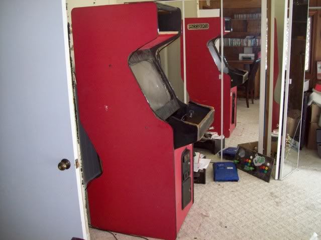

What kind of cab is this?

I got this cab for free and its missing some parts. I would like to know what kind of cab it is and what game it was originally. Also, if someone can link me to a picture of this cab I would like to see what the control panel looks like. The control panel assembly slides completely out. If anyone know where I can buy a new CP and assembly I would be interested because this one has water damage. The guy I got it from thinks it was a Lethal enforcers cab last. It is set up for JAMMA and has a 25" monitor The monitor works great! Thanks all.
You can see a Capcom sticker but I dont think it was a Capcom game.

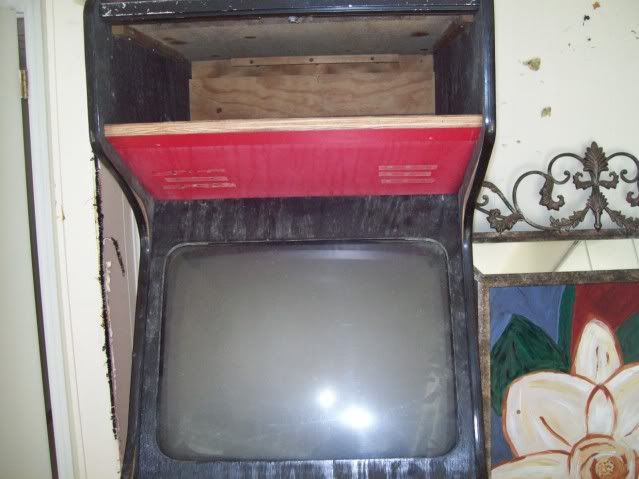

P.S. - I also need the lower marquee retaining bracket as seen in the pic. Any ideas?
Dynamo, I beleive...
That way my thought also. Did Dynamo make Z back cabs. That Pull out drawer is DA BOMB for MAME units. For the control panel if you are handy you can make one out of wood, or more than one as others have done. It looks like it had an oversize control panel on it at one time. Piano hinge fastens it in the front and lock down clip parts are available from many folks here.

"3-KOAM" should be the manufacturer.

That cab was probably made be Plateau Inc.
There should be a sticker stating that, as well as a model #
somewhere in the monitor cavity and somewhere inside the coin door.
That cabinet was slightly modified to hold that monitor, since the
original would have had a 19" monitor mounted to a bezel board
so that it could be easily rotated.
The control panel itself would be just a sheet of plywood that would
slide into those grooves on the control panel shelf.
If I remember correctly, a 1/2" sheet of plywood topped with a 1/8"
sheet of plexiglass should be a perfect fit.
There should also be an extruded aluminum piece that would mount to
the control panel that would seal the gap between the control panel top
and the glass monitor bezel.
Here's a pic of the cabinet model with the mono speaker.
http://www.wickedretarded.com/~crapmame/12.html

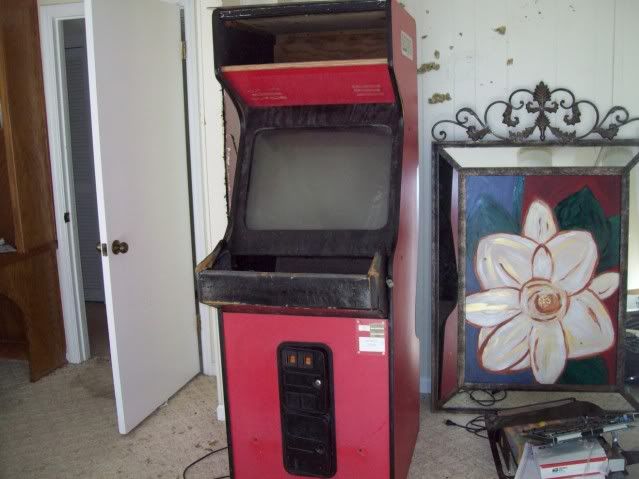

All I can find is angle mfg 10/5/93 in th spots you indicated. The monitor does look like it has been messed with, particularly the mounting bolts.
I was going to make a whole new CP and shelf and just make the CP long enough to seal the gap between it and the monitor.
Should I be using MDF for all this?
Plywood would be better. You are going to have cut an angle at the rear and plywood holds up better (in my opinion). Install your joysticks and buttons first and when you think you have a setup you can live with install the CPO.

If you plan on basing the new self on the old one, then it would probably
be best to go with mdf since that was what the old one was made from.
The control panel itself can be made from any material so long as it will
slide into the slots in the cp shelf. It's just a rectangular sheet of wood.
The cabinet I had was made sometime in 91, which would explain the
change from a mono to stereo configuration.
It's possible that the manufacturer changed it's name sometime between 91 and 93.
Thanks all. I got 2 good and free sheets of MDF out of the scrap pile at Lowes today. Nothing better than free.
