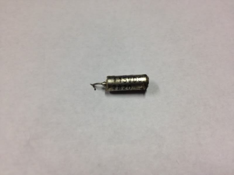

What is this?
ArcadeGreg
Permanently Banned
Oct 5, 2010
1,534
19
Texas
There are markings on it, as follows:
+NCI
22K
+15VDC
7820
Actually, the picture is of a tantalum capacitor. Tantalums tend to age better as they don't lose capacitance over time like electrolytics do...but when a tantalum fails, it tends to do so most nastily.
This appears to be somebody's attempt as a pulse stretcher -- introducing an RC time constant to stretch out the low time period.
Ed
Ed
Williams system 3 to 7 had these on the slings and pops switches.
That's what it came from (Williams System 3 pop switch).
Will a regular 22uf 15VDC electrolytic cap work in its place?
