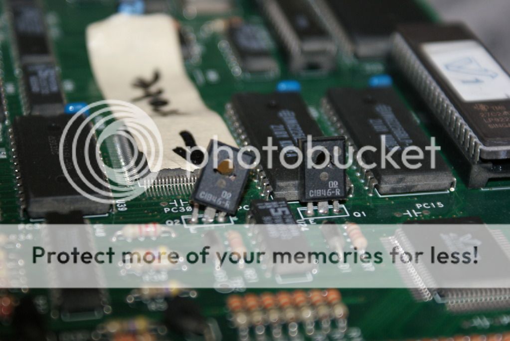

Ok got this pcb and looks like it was dragged around, obviously abused...
What is this part called and where can I get one? I want to see if I can get this board to work. Part # on it is C1846-R but the only information I can find on it is in Chinese.

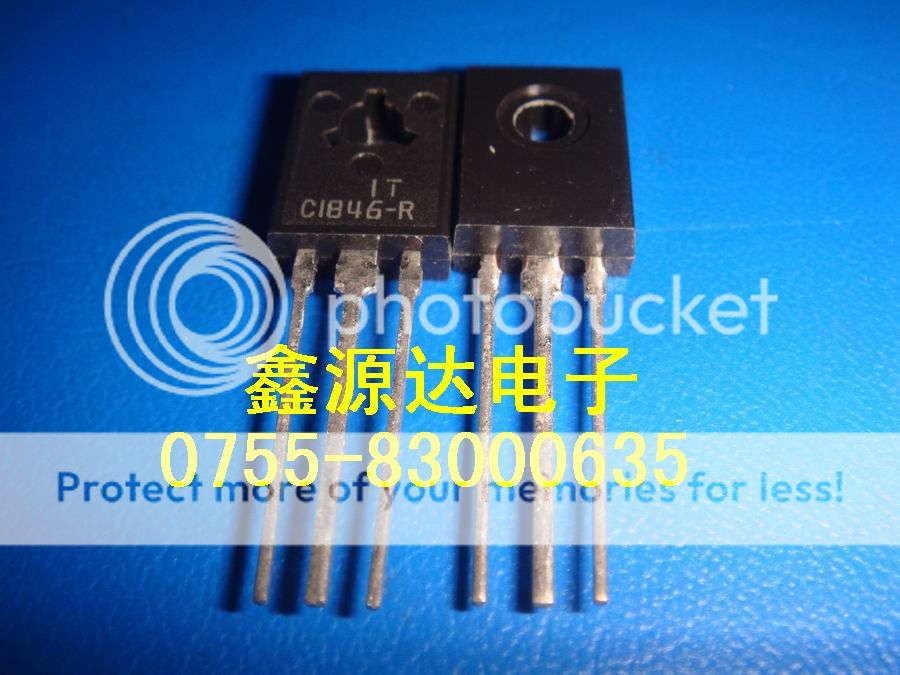

MCM Electronics is a good source for any kind of "2S" transistor. They have the 2SC1846 in stock for $0.47.
Jeez, that's like a baker not knowing what a donut looks like. Some expert.
Here is the link. They have free shipping for orders 199.00 and up or you will pay 8-9 dollars for shipping.
http://www.mcmelectronics.com/product/2SC1846
for 25 of em it is only like 10.75 + shipping.
