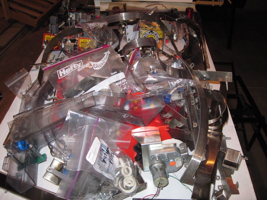

I am a complete noob when it comes to restoring pinball machines. I don't even know what the parts are called. I think I bit off more than I can chew with this Capcom Airborne pin. I've taken most of it all apart (the plastic bits) and want to start cleaning it and putting it back together. There are a few issues:

A tip that helped me was putting everything in baggies. Made keeping screws etc with the associated parts easy.
(and tons of digital pics!)
