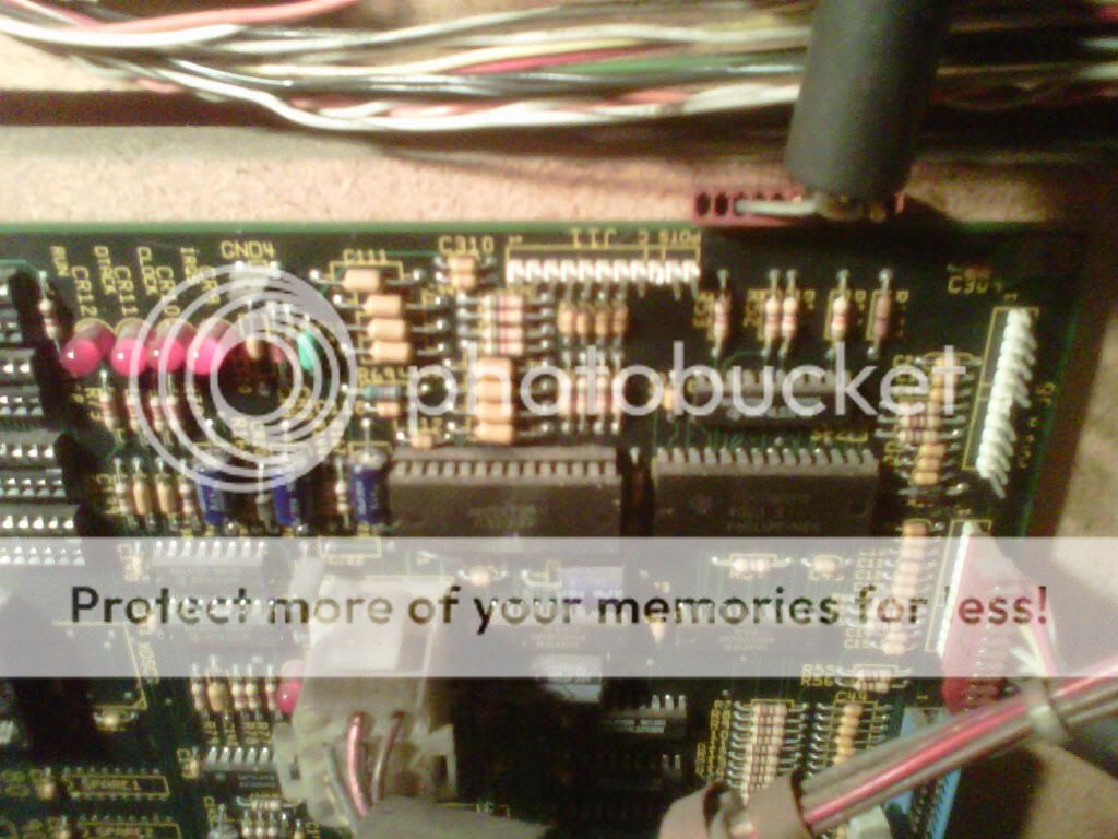

I'm not an expert on these but have worked on them and the "APU" board doesn't sound familar. Is it in the main stack of boards or mounted elsewhere?
That's the board that drives the steering motor isn't it? Check where the wires are going to. If so, from what I know it is a high voltage board and needs to be worked on with respect to the high voltage. Anotherwords, don't jack with it powered up. Does your steering motor have a belt drive or just one large motor directly attached to the steering wheel?
The APU board is not the steering board. If you look above the APU board mounted to the right of the monitor chassis you'll see the steering amplifier board.
The APU provides audio amplification for the speakers and AC power to the shifter board as well as provides a portion of the circuitry (a transistor and other stuff) for the seat magnet, wiring for the key switch, 12v to the coin door and a few other things.

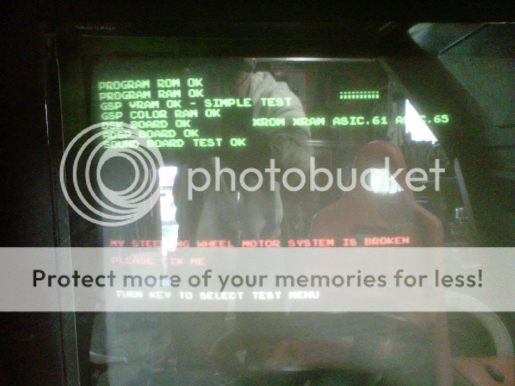

After a little troubleshooting and unplugging stuff one board at a time It seems for some reason my steering is not properly working (or working at all). I can boot the machine up with everything attached as it should be and it just scrolls "drive" on the screen. As soon as I disconnect the J11 pots c that seems to go to the steering motor or potentiometer it boots right up (no steering or sound though).

Here are the pics...
http://i545.photobucket.com/albums/hh394/bjinatj/forum pics/board.jpg
http://i545.photobucket.com/albums/hh394/bjinatj/forum pics/screen.jpg

Ronnie: you mentioned that the game boots into test mode. Race Drivin' has an extensive set of testing software built in. Did you test *everything*?
If everything test correctly, there's a good chance you have an issue with one or more of the EPROMs.
it will boot into test mode and do it's initial test. If I hold the key and go into the advanced it will bring up the menu, but as soon as I select anything it will reboot back to the menu. It will not let me actually run anything beyond the initial self tests. This happens with 2 RD boards and a HD board.
