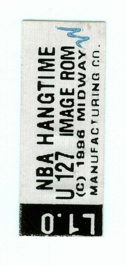

This is mainly for looks as many of the 90's midway games don't use window style chips. As i'm still working on them i haven't gotten into what to recommend for adhesive and removing the existing adhesive i don't think will be required.
Steph is going to hook me up with the file he has and i'm going to try and make some revisions to it or add to it.
this is basicly what i'm going to make:
attachment.php
i just cropped this out of a picture of my TE board that i have, I have an original NBA Hangtime u127 label infront of me right now and have 3 other boards to scan chips off of that have been replaced (nba jam TE, UMK3, NBA Jam and KI2) which i plan on doing tonight or tomorrow depending.
Has anyone ever seen a L2.0 or L4.0 or any strange 10th digit? just wondering if i should make those up also. I've seen L4 but not L4.0
5/24 got around to scanning the U127 i have i've attached the image, but here's a link to the original scan (1200dpi goodness) http://img.photobucket.com/albums/v218/nismo240sx1/Arcade Game/U127.jpg
