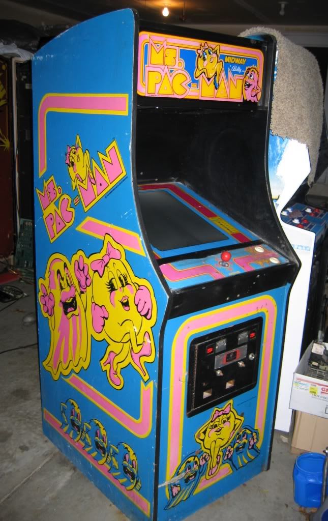

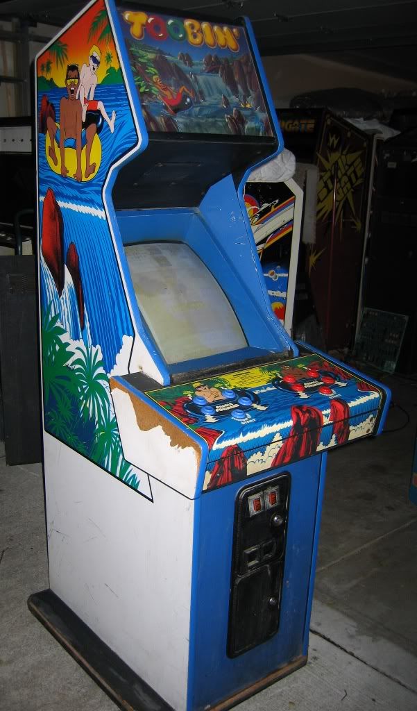

MsPac has a hacked wire harness but board and monitor work, Toobin works but not sure if the waterfall does yet.
That Ms Pac looks great, the pink looks good in the cab art and marquee. Usually those are faded almost white.
Congrats on the score(s).

Is that some bad reflection, or does toobin have some other games screen burn on the tube??
If you lucky someone uplugged the waterfall.. If not, I think someone posted a motor fix a while ago..
Ok, you got me curious....just went outside and checked the waterfall motor, someone did disconnect it but for a reason. It appears the gears are all gummed up and are not easy to move. The wires were cut to the motor and when I hook em up the motor works but can't quite turn the rollers. Looks like another little project to add to my "projects to do list".
Strip the gears of the old grease with carb cleaner and regrease them,do not use WD40 or any type of spray lube.
Absolutely. I had to do that on mine. It was noisier before, but they'll always need taken apart, cleaned, and lubed.
