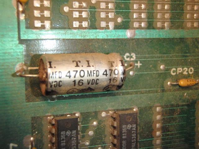

Check your voltage on the main pcb and see what your getting. Check across cap C3(I think)...its the smaller one right behind the two big ones. You should have +5 there +/- .2vdc
If its low check inboard side of the two large diodes and the two 1n4001's on the top right. If your power is around 2.8-3v on cap C3 then you probably have a bad transistor on the big heatsink. Replace with a TIP31, I use 31C.
If you have a good 5v across that cap then the board should run.

As you suggested, I took voltages on C3 first. Got absolutely .04 - .06 Volts.
http://i464.photobucket.com/albums/rr5/AOW_Waterborn/Coin-op Games/PB240002_01.jpg
Then for a lark, I check V's across the two big Caps above C3 (C8 7 C9 I think) and got the same results. I started to check other points and caught a spark which fried all four fuses coming out of the low voltage side of the transformer.
Not sure what to do at this point. I fear that I am taking these measurements incorrectly and that to continue will just cause more issues.

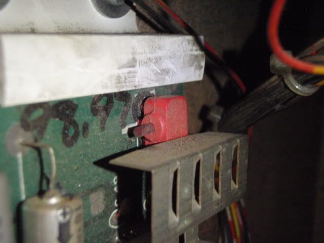

Another question: What does the red micro switch on the top right of pac-man boards do? If I accidentally hit this would that screw anything up?
http://i464.photobucket.com/albums/rr5/AOW_Waterborn/Coin-op Games/PB240001_01.jpg
Any additional help or ideas would be great. So frustrated right now.
The red button is just a reset, wont hurt anything to push it.
