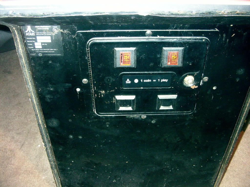

I have a gen 1 Tempest cab that came w orange coin lights. My Atari Asteroids came with red coin lights as did my Atari BZ. Should I leave the lights orange or swap over to reds?
Your bulbs are colored? Or that is the color of the inserts? My inserts are the standard red with clear bulbs on the Tempest.
Atari used Coin Acceptors, Inc. (a.k.a. Coinco) model 2802 coin doors during the production run of Tempest. Orange reject buttons would indicate this was the latest coin door from Coinco (red button doors were earlier).
The orange button doors were different from the red button doors. You can't just change the buttons because they are physically different. Other parts must be changed as well. Here is the parts list:
http://arcarc.xmission.com/PDF_Coin_Mechs_Etc/Coinco/Coinco_2802_Series_Game_Door.pdf
Good luck trying to find the correct parts. Coinco has been out of the coin door business for at least 15 years. Stocks of new-old-stock parts are drying up very quickly.
Mine are orange Serial # 2897
My previous Tempest was also been orange Serial # 14242
mine is 0112473 and has the orange inserts. The cab is the one without the orange stripes. And like Ken said, my 2nd cab has the kind of coin door where you can see the bolt heads outside the machine. The edges of the door on cab 1 are rounded and no bolt heads are visible. I like that one better but the coin inserts look orig but are orange. I love how the red inserts look on my other games but didn't know if I should swap out the inserts since the orange ones look like they came w the cab from day 1.
Wow it's getting interesting to see how many of these games have orange inserts. And btw, the serial num I gave is the one that's on the frt of the machine. Is that full num actually all the serial num or just a portion of it?
I believe it is the full number.
