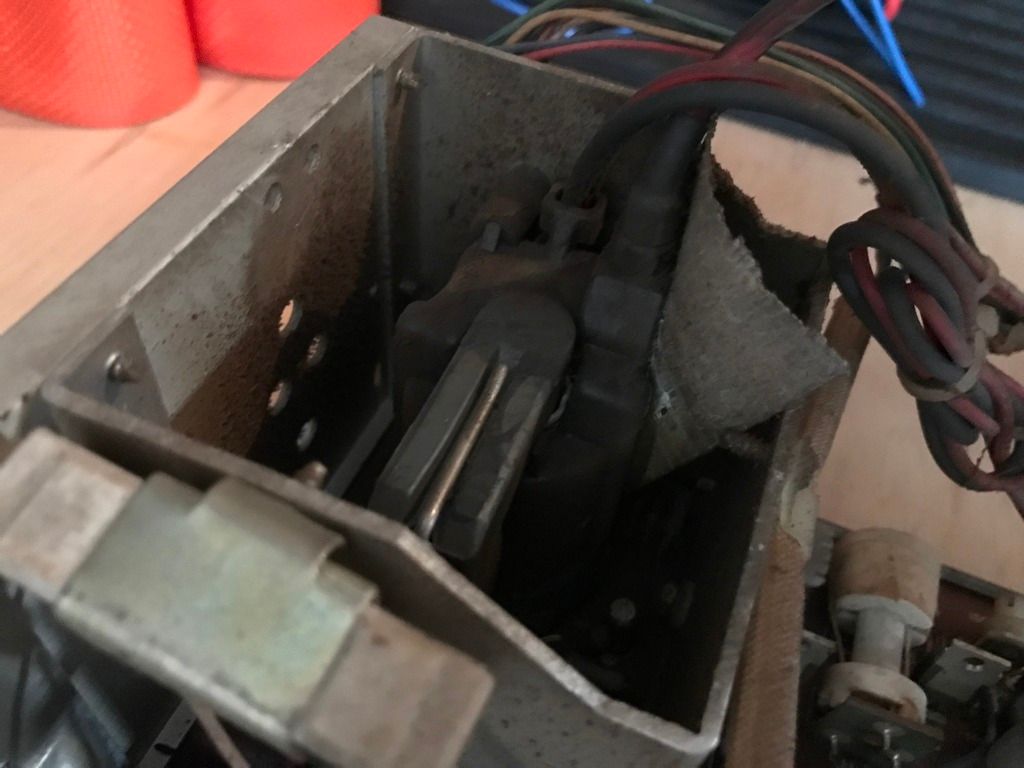

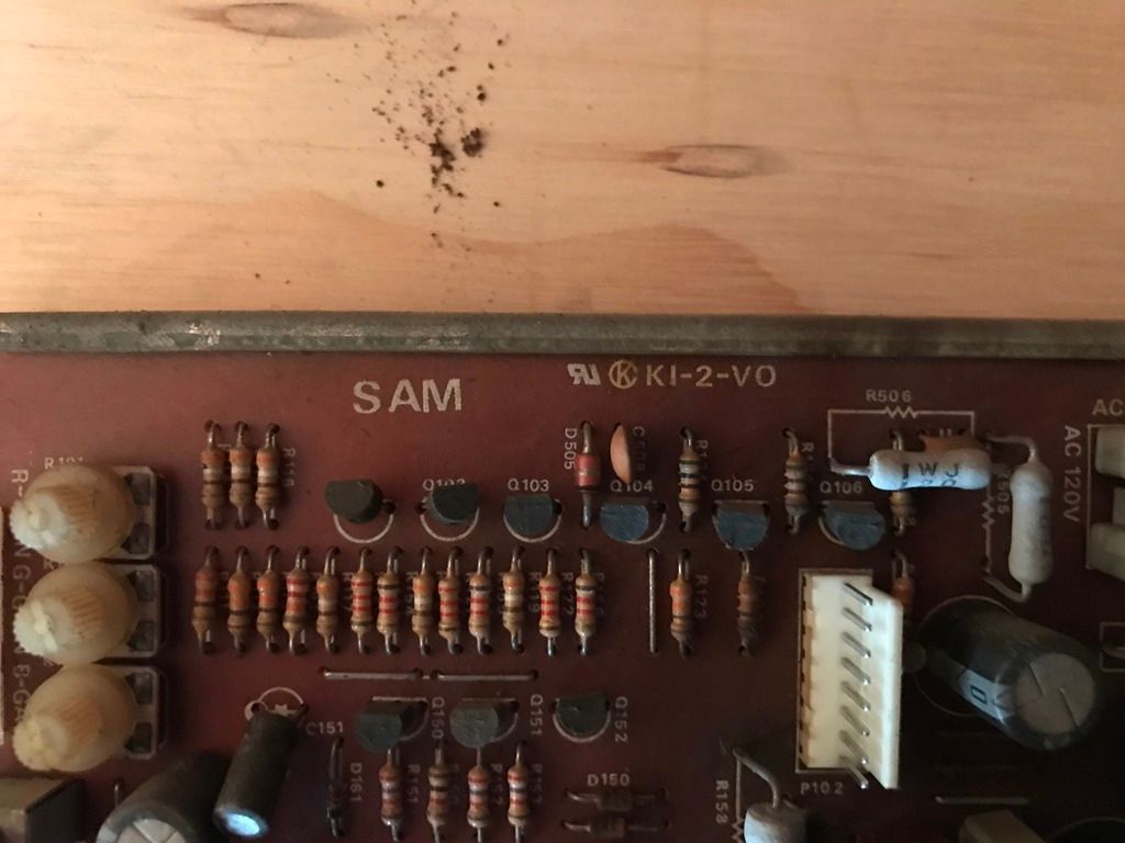

I recently picked up a Pac-Man and discovered it has a non-original monitor in it. I think the chassis is a Kortek and it has model KI-2-VO silk screened on the parts side. (Nothing printed on the solder side)
I think this is more commonly known as a Kortek KT-1420A chassis. However, can someone confirm it before I try and find a cap kit for it?
Here are some pictures of the chassis:
Also, if yo notice on picture #3 there is some duct tape on the side of the flyback. Is that ok!? lol
Ian from iankellogg.com got back to me faster that expected. He confirmed it is a Kortec KT-1420A
He is now offering this cap kit on his website if anyone stumbles on this thread looking for one.

Oh, the tube on this chassis was a Goldstar.
And when I attempted to discharge it, I didn't hear the usual "pop" sound, when I stuck the screwdriver under the anode cap.
The machine was powered on 2 days befor that.
Is the chassis/tube somehow self-discharging?
