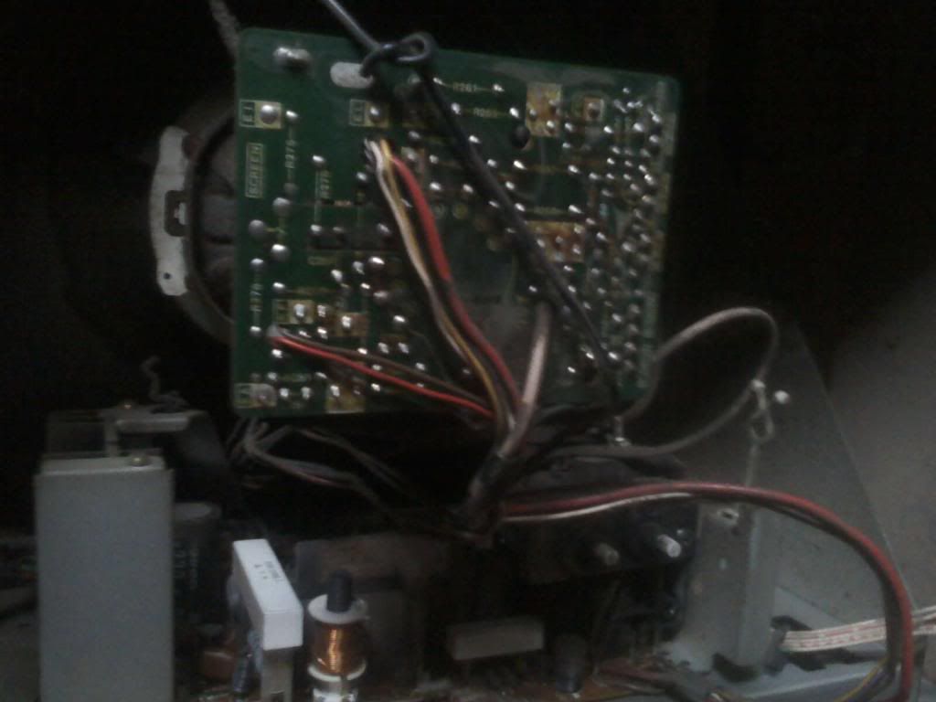

Im trying to identify this chassis. I know its a bad picture. The guy sent it to me on his phone.
Hilarity
That video cable and tall heatsinks (20EZ's are shorter) behind the width coil have me thinking it may be what's on my bench right now...
It appears to be a 13/14" chassis with a full square PCB, unlike the Atari 14" with the cutout. Cap map is close to a 20EZ and the 13" AZZ, but not a perfect match on either. Also close to the EZZ variants, but again, not quite right.
Of course, one would assume this Centipede is a 19" setup, so it's probably not, but here's some pics of what's on my bench now for shits and giggles.

Sanyo 20-EZY. Almost the same as the Z, but non-inverted video, no flyback cage, and no sound amp. Ive got several of them in Dig Dugs.
Yup....the easiest way to tell the difference, the filter cap. EZV's use a 470uf at 160 volts.......the EZY uses a 330uf at 200 volts. You can just barely make out the 330 on the filter cap in the original posters picture.
ballytablewiz, yours looks like a YZL 19".....very early Sanyo monitor.
