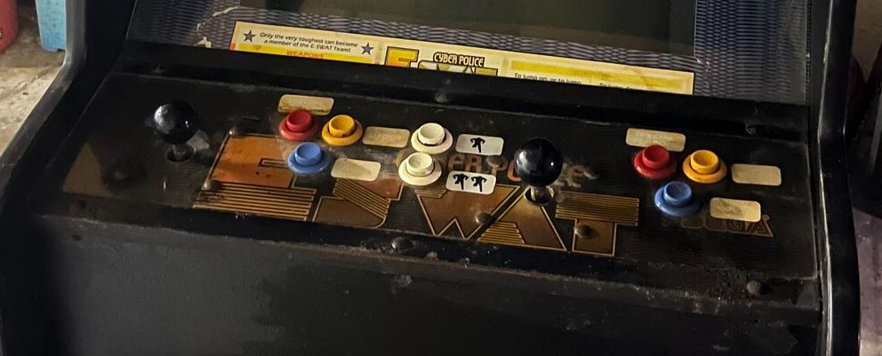

Looks like some sort of generic Sega or knock off, but I can't place it. Anyone?

Cinematronics / Rock-Ola Armor Attack or Star Castle.
The best give-aways are:
- CP metal bars
- Cab side-view
- Single speaker
Based on his VAPS page, OP owns no VECTORS, so it makes sense he could not identify it. LOL :)

If you review the CP, the top angled metal piece and the front L-shaped piece is definitely off of AA or SC (or similar Cine/RO game).
Given the player1/2 button locations, it likely was an AA.
I agree. Clearly a SC or AA game. You can see the white base peeking out from the black overcoat of paint.
