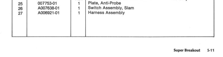

First result in GOOGLE for "A006921 K&S" ...
>> Super Breakout Harness (coin door) - page 5-11 table
Though likely the blue tag is not applicable to the harness shown. As the table relates to the smaller coin door harness.
I googled without "K&S" and it came up with Starship, but when I looked through the manual, I couldn't find any reference. I do agree, it looks like the tag is for something else, as a coin door harness is much less.
I don't think that blue tag has anything to do with the harness shown.
