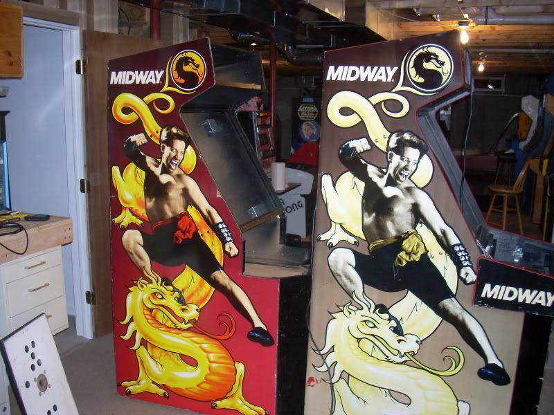

well $35 in the form of a auction won mk2 cab and the stripper is Citristrip. All thanks to this thread :)
http://forums.arcade-museum.com/showthread.php?t=167111
left side is faded but it already has a home with the right front and center. Still has some work to be done, ran out of brake cleaner.. I have wanted a mk2 for so long, now I own one :)

how thick was the paint you removed and how long did you leave the stripper to do the nasty?

not sure what im doing with cp yet, was thinking patching but im not sure. I did it all standing up. paint was very thin, I pretty much went all or nothing. Started at the top and spread stripper over the whole side of the cab then after 1-2 min started to remove with plastic scraper, then simple green then another quick scraper round then brake cleaner. the chainsaw was incase I messed it up ;)
awesome job, the paint on my mk1 seems really thick, like a couple millimeters. i wasn't sure if it was possible to do it standing up, now i know. :D

Looks great! Congrats! MK2 is my personal favorite of the MK series and I've always loved the side art....just looks bad ass. I had very good success with removing a horrendous paint job from a dedicated MK1 cabinet last fall. I also used Citristrip and it worked like a charm. The cab I had previously was horribly faded and getting the better cab helped push me to finish work on the MK1.
