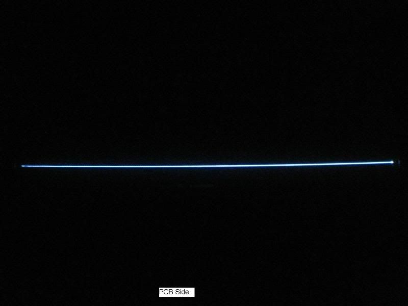

The first picture is during the white-balance adjustment procedure, with TP302 tied to ground (TP301). Notice how the line gets a bright spot at the right-hand end.
http://i129.photobucket.com/albums/p205/mark129845/IMG_1239.jpg

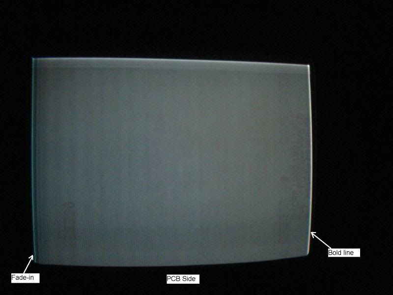

The second photo is also during the white-balance adjustment procedure, with the jumper removed, and the screen control turned up just enough for a even grey screen. Note the whole right-hand edge has a bright line.
http://i129.photobucket.com/albums/p205/mark129845/IMG_1238.jpg

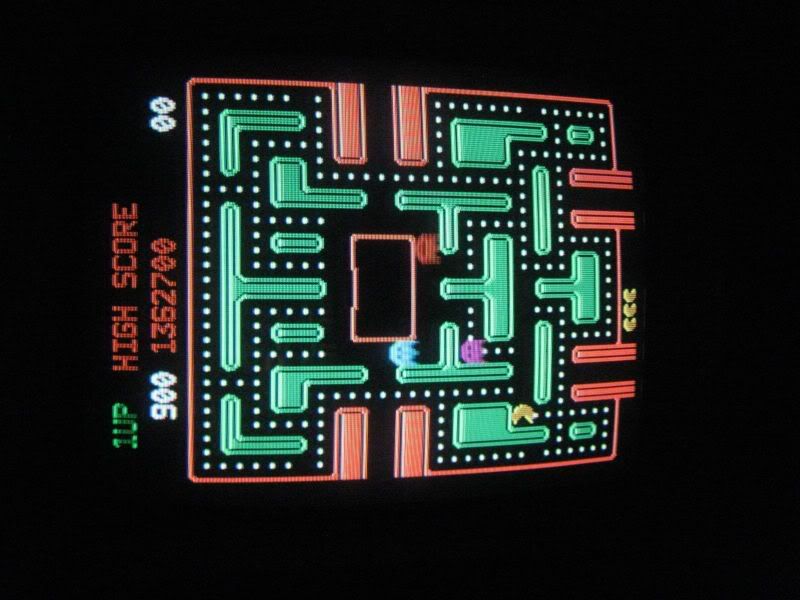

Do you have a game? Hook it up to a classic game and let's see what it looks like....
Yeah, it's in a working baby pacman. The game is definitely playable, but after doing the cap kit, i was basically expecting the picture to look almost new (except for the small amount of screen burn)
The distortion is bugging me. I'm pretty much ignoring the game at this point, because it's much easier to see the problem during the monitor adjustment and color bar setup.
You can see the color distortion anywhere there is a black line on the left, followed by a colored line on the right. the easiest place to see it is about 2 "pac-man widths" to the left (or above) of pacman in this view. See how there is a bright vertical green line on the left edge of the green field? You can also see it on the red escape tunnels
http://i129.photobucket.com/albums/p205/mark129845/IMG_1243.jpg
