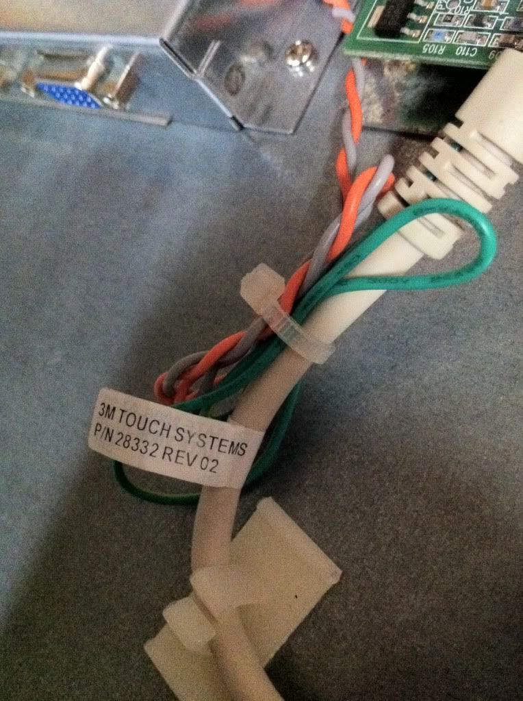

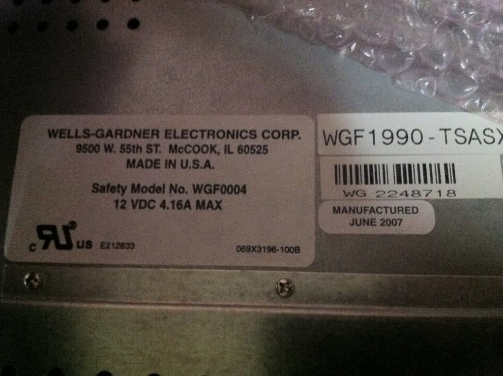

I was gifted a few of these WGF1990 LCD 19" panels that were samples. They were supposedly used in slots and work. I'm asking if anyone has any info on them like where I can get a cheap power supply alternative (been looking at mouser, etc) but I don't know the minimum amperage required to run it. Also it is a touch screen and has an attached card on back, anyone know where I can get the drivers/pc interface card?

The label says 4.16A MAX for the power supply.....might give WG a call and see what it is truly rated at.
http://www.wellsgardner.com/products/details.asp?iCat=1&iSubCat=5&sRelatedPartNum=WGF1990-PDSS24G
Or at least find a cheaper place by searching their part number 053X0679-001
http://patriotgaming.com/catalog/product_info.php?cPath=10_970_971&products_id=4493&osCsid=shnwpuvtq
Just make sure you get the cord that goes with the "brick". (seems to always be sold separately)
As for the touchscreen drivers - it's a 3M controller, so you just need the drivers for whatever operating system you're running (WinXP, etc)
http://solutions.3m.com/wps/portal/...uchScreen/CustomerSupport/TouchScreenDrivers/
