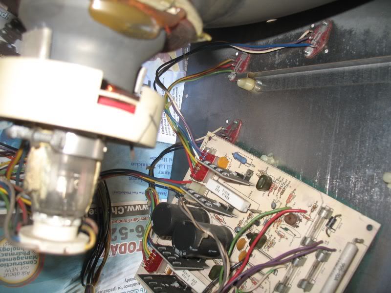

So I took the deflection board off the metal frame so I could cap it and I can't remember what you use to mount it back on to the metal frame . Is there 4 screws I'm missing ?
The board will slide back into the bracket closest to the tube, then you'll use two screws to secure it in the plastic standoffs at the rear of the frame.
