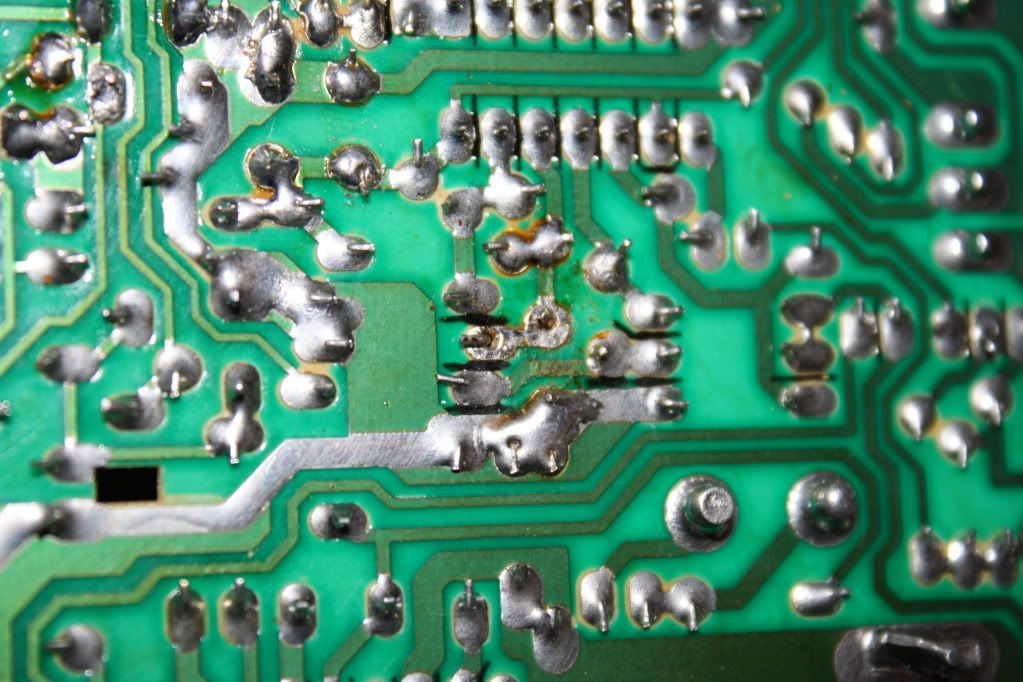

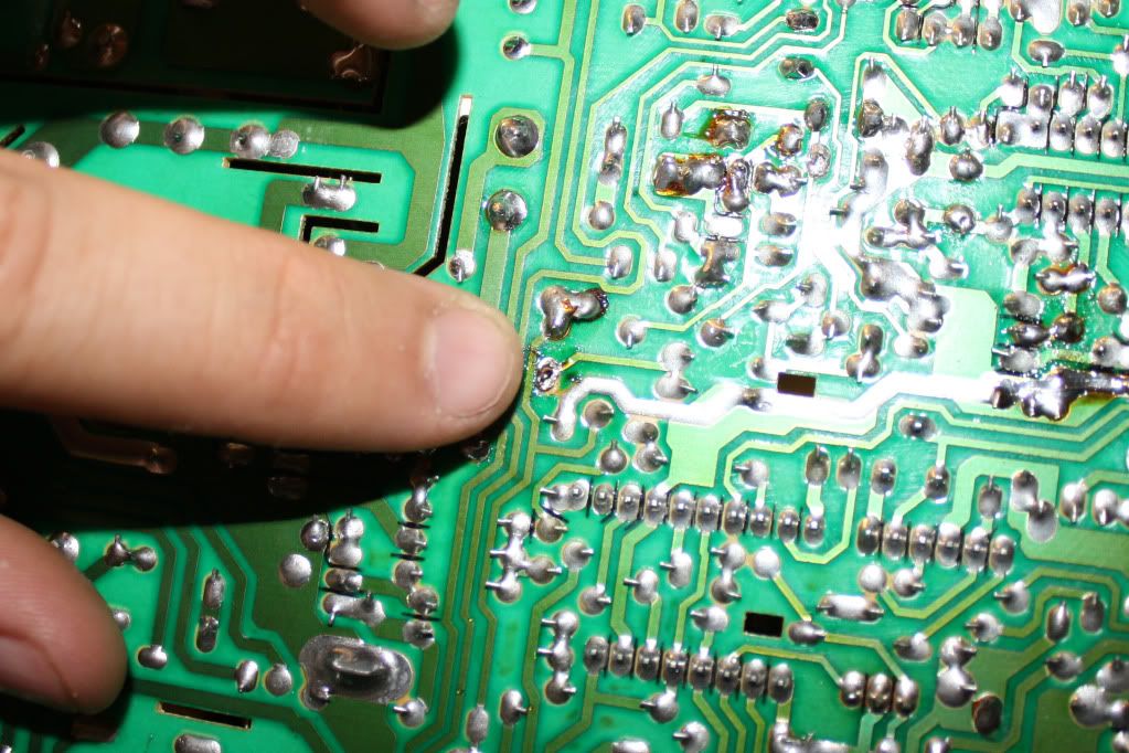

Ok i looked through this thing with a fine tooth comb. for about an hour and found this solder bridge
I desoldered it and it looks like they are supposed to be bridged...

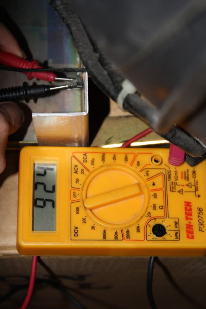

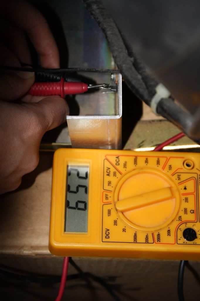

This is me testing what i THINK is the hot...
This is the other side...

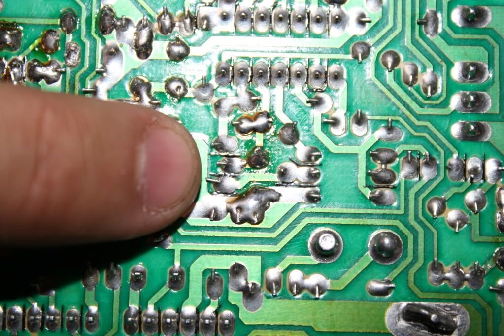

Lastly, i found a pad elevated from the PCB a bit, i desoldered it and sure as shit its not on the PCB anymore, HOWEVER, it is still connected to the tracer... not sure if i can do anything about that.
should i go ahead and put some solder back on the thing?
I definitely know that I dont have any backwards caps. I double checked the plastic guide area and didnt see anything unusual there everything looks normal except for some discoloration from what i think is heat but nothing looks burned or smoked.

That's not the HOT.
The HOT (Q704) is on the heat sink next to the flyback (the large one at the left-most position), it's a C3688 transistor.
In your picture you're testing the BDX53A (Q709 or Q710?), which has something to do with the width on the 27" model, but it is not required to be hooked up for the monitor to work. It's not your problem.
Yep, that's not the HOT.

Desolder it, pull it out and test again to be sure. Sometimes when one thing shorts (especially on the horizontal circuit) lots of things test bad in circuit because there is a short to ground. To be sure you need to remove the part and test again.
im one step ahead of you, once i tested it i took it out and retested it. its bad for sure... are these expensive or hard to find?

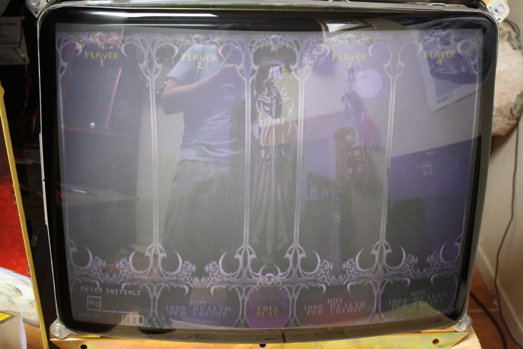

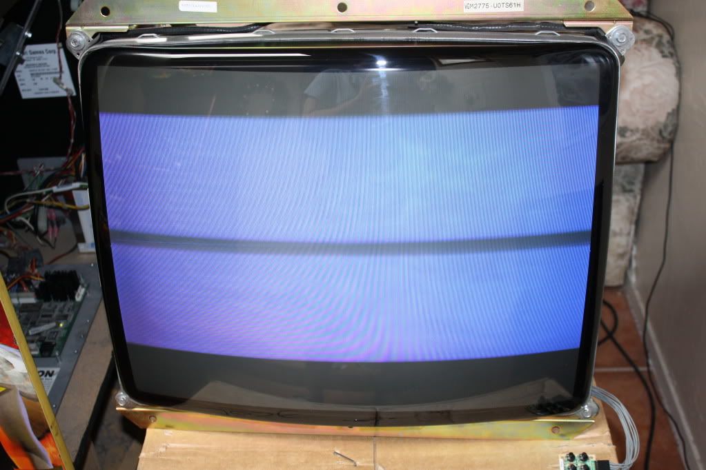

GREAT SUCCESS! I got a new hot installed along with a new C734. The monitor now comes on and displays images (poorly) it looks like all the pots need to be readjusted. but its working atleast!
This was what it looked like at first

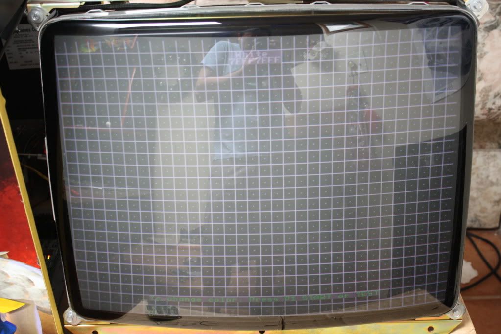

This is after adjusting the remote board pots.

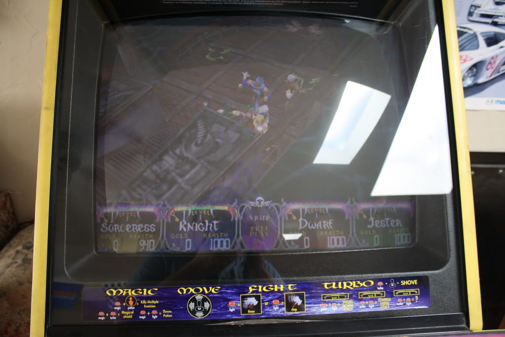

Got it as close as I could, adjusted the fly back and the pots on the neckboard. It looks kind of dim because I have the monitor under a skylight so there is a ton of glare but im sure it'll look awesome when its in the cab in a darker room!
Thanks to everyone who helped me with the repairs! Cheers fellas! : D

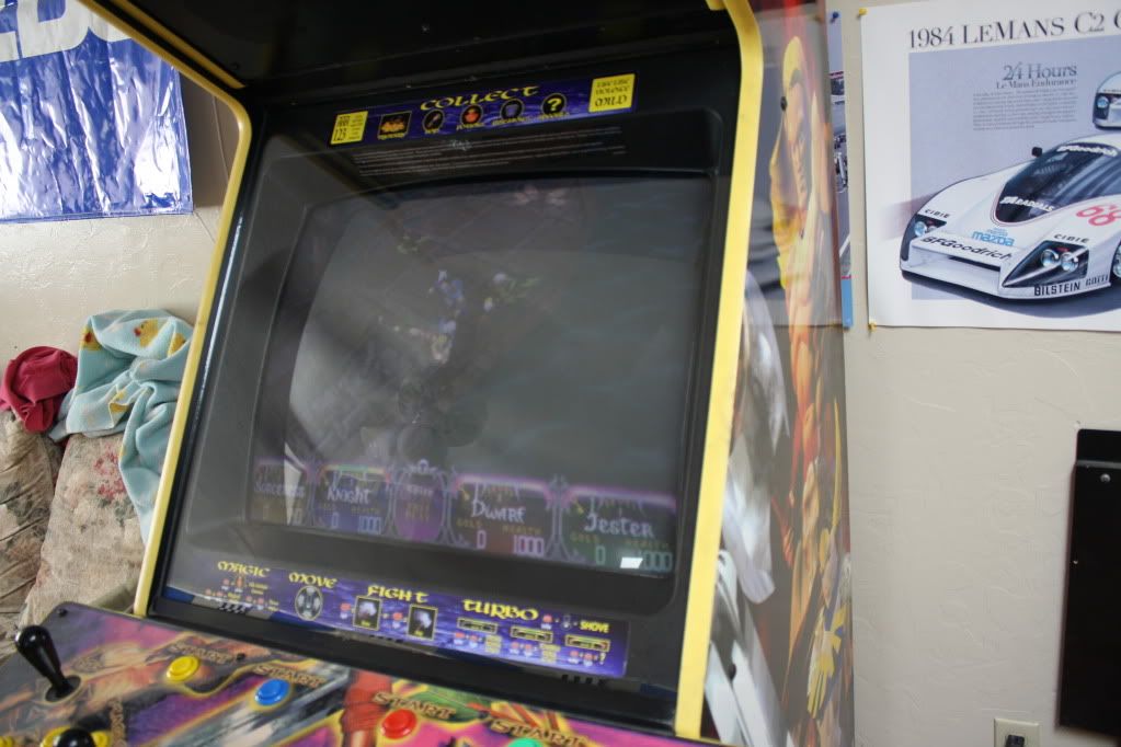

Put the monitor back in, its lookin really sharp, ill stop spamming pictures now haha sorry guys.
