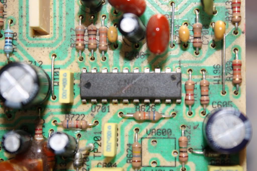

U701 looks fine it doesnt look burned or anything, how could i even replace that?
U701
U702

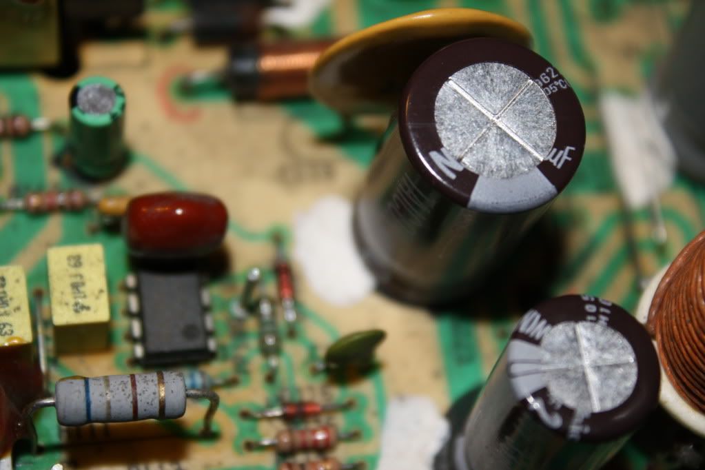

Ok I got my cap kit today, started working on it at 10 pm and I just now finished (3 AM)... i have a few questions...
I noticed there where a few caps missing and a few spare caps...

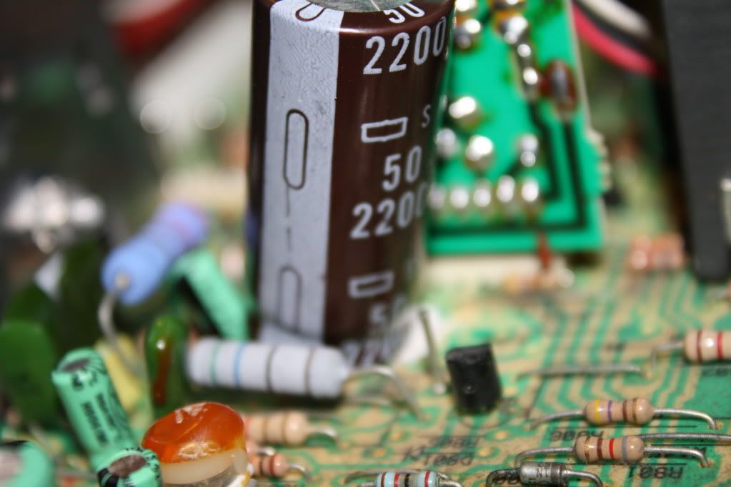

C616 Its just so much bigger than the cap that came off of it but according to bob this cap in the one that belongs here.
C729 its just so much smaller than the allotted space. Makes me think that this cap is wrong... oh and on a side note, there was nothing on C729, It was empty when i started.

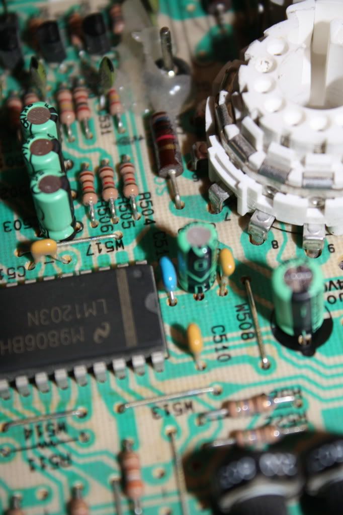

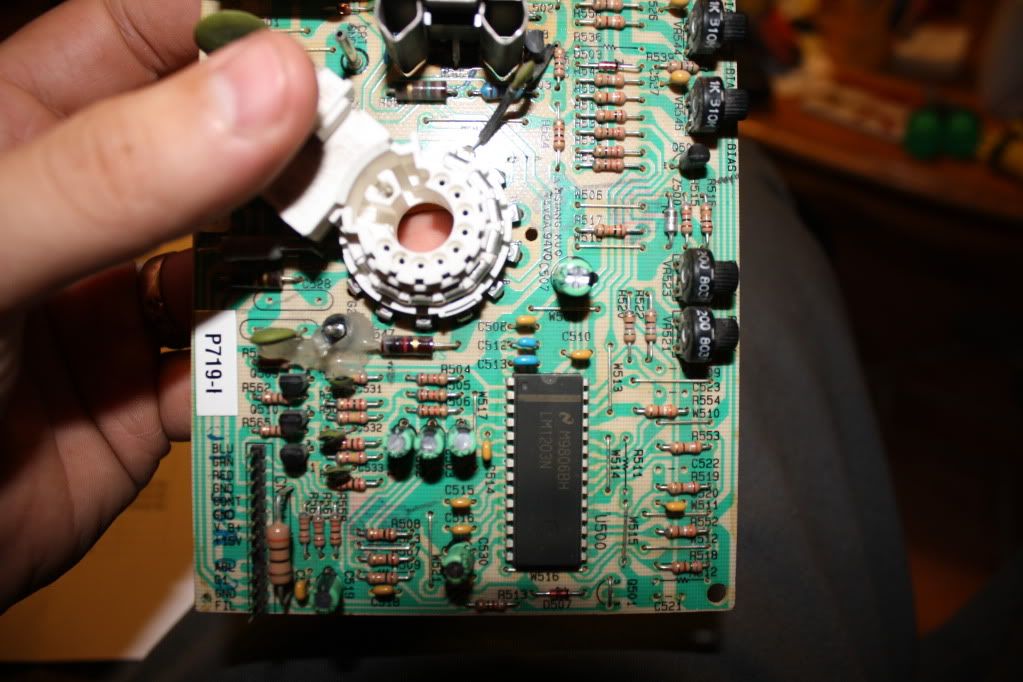

C512 (neck board) Doesnt even look like a cap(looks like a small blue resistor looking thing) not sure what the polarity would be even...

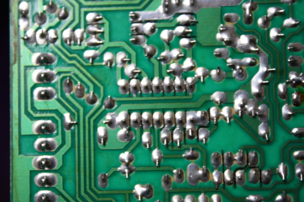

Ok so i have now double checked and triple checked everything and I found 2 errors I made (luckily I didnt hook anything up or power anything on)
I have 7 spare caps in my U2000 K7400 K7500 combo kit. Of those 7, 5 of them are for the other chassis and the other 2 are spares. all the correct caps are accounted for.
The two errors I found where...
1. I had a the wrong cap on C115, I had a 220UF 100V when it should have been a 100UF 200V, so I fixed that.
2. I had a cap on backwards so I desoldered it and put it back on the correct way.
C512 Before
C512 after, I hope I got the polarity correct
What do you guys think? does it look ok?

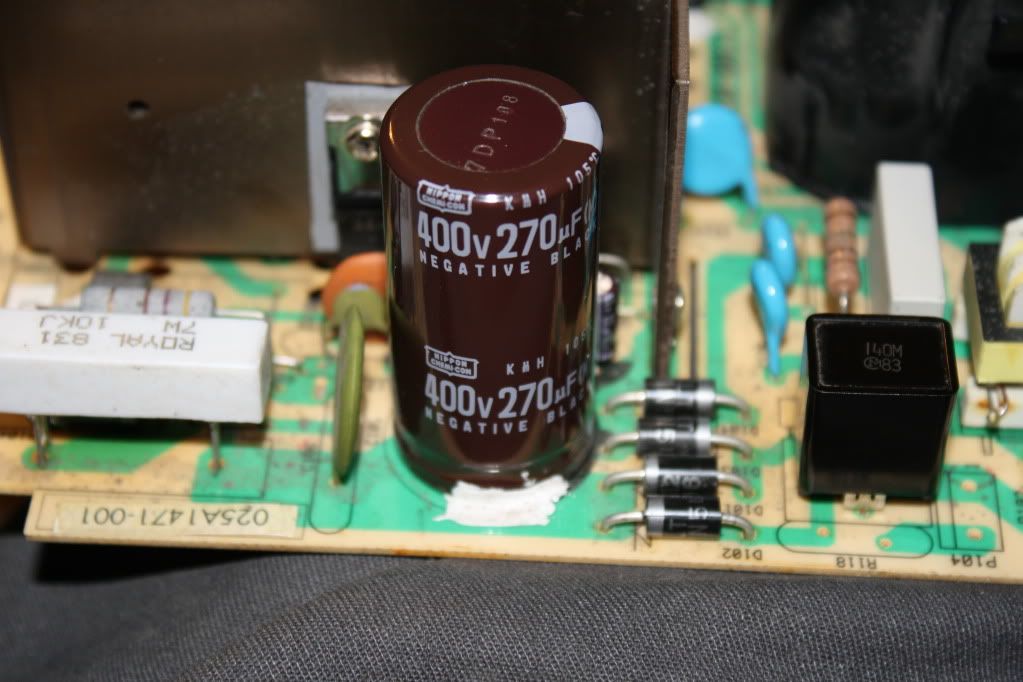

1) As mentioned, the kit you get from Bob is made for all variations of this chassis, so some caps won't be used.
2) The 470uf cap is the filter cap and is almost never included in the kit. That 330uf cap and any other polarized caps should have been included, though, in my opinion.
3) The neckboard cap is in correctly.
4) The big 2200uf cap Bob sent you replaced a 1500uf cap that was there originally. The 200uf will work, although I always order 1500uf's for when I cap these.
5) The cap size difference for that one cap is fine...

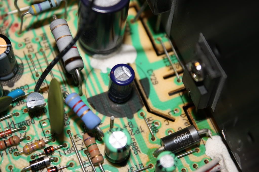

ok i got the monitor put back together and plugged it into my gauntlet dark legacy cab and all i get is a ticking, sounds like a clock, coming from the flyback i think... not sure what this means...
also i would remove the cap you installed that was never there. if it always worked this way, i would not be adding components to it.
the K7500 and K7400 will have ONE cap in either spot. meaning, the K7500 has a cap in one spot, and the other is empty, and vice versa for the K7400.
I can't remember specifically which one is which, so I hope you remember which one needs to get pulled out.
the "extra caps" are for a pincushion board if you have a 27" or larger tube. I can't remember if those Gauntlets had 25s or 27s... they're like the other Midway cabs but a little different.

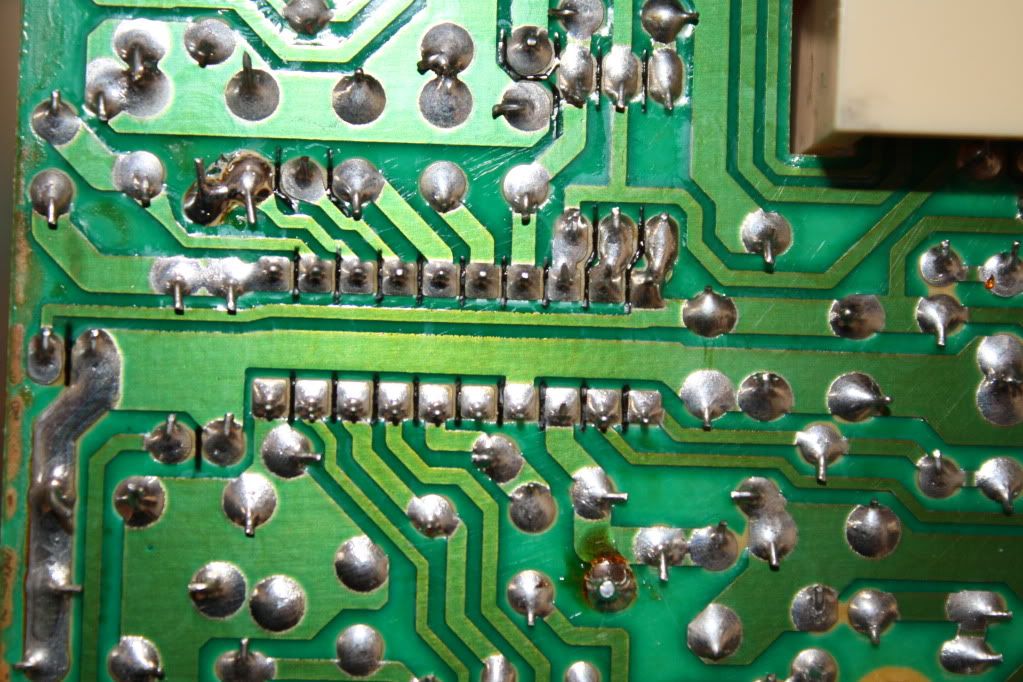

now I'm not sure if having that extra cap would cause your ticking issue, but if you happened to pop the HOT having that cap in there, that will cause your ticking. without horizontal deflection, you can't have high voltage. the only other thing I can think of is that you made an error in your solder work elsewhere, perhaps a solder bridge between two joints.
I'm no scholar on the subject, but I suspect that the primary difference between the standard resolution K7400 and medium resolution K7500 is the jumper wire arrangement in the middle of the chassis and that either-or cap placement. there's probably some other shit that's different, but I'm also going to assume you blew the HOT having that other cap in the circuit, if it's even attached to horizontal deflection. I don't memorize anything with these at all, soo....

its a 27 and it does have the extra pin board and I did replace the caps on the pin board aswell, I should have clarified that.
This is the extra cap C729
I'll take that extra cap out and try again.
I'll also look for solder bridges too! Thanks for the advice!
