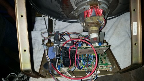

Just pulled a picture that I had uploaded to KLOVIMG a while back, of a K7191 I was working on, and lo and behold, I captured the input header in the pic.
It is on the right side, just north of the screw that is securing the chassis to the spacer on the metal frame.
It is a "10-pin" continuous header, but is actually labelled as 2 connectors - P1 and P2.
The pin closest to the screw is pin 1. The pin closest to the tube is pin 10.
You want RGB and video ground landed appropriately on pins 1-6. Sync will go on pin 10 (closest to the tube). There is no pin in the #7 position.
Hope this helps. If you see something different on your chassis, post a pic.
