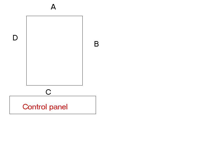

I've got a 25in WG k7000 that I recently recapped. All caps except the filter cap. It still has fold over though along one side. This is my jamma cab so I tried a couple of different boards in it. First I tried my strikers 1999 which uses a vertical monitor orientation. With this board I have fold over along the right side (B in the pic below). I also tried a game that represents horizontally simply because I had the board handy. For this board "D" in my pic is the top edge, "B" is the bottom, "C" is left and "A" is right. With this board the fold over was along the D side of the monitor. Basically across the top of the screen.
Any ideas what might be causing the issue? Any help will be appreciated.

Thought I tried all the pots but I may be wrong. I'll look into that.
The 50/60 hz pot is going to be behing the horizontal hold pot. It faces up and you need a small flathead or monitor adjustment tool to adjust it. Here's a picture that should help you find it. Keep in mind the arrow is pointing behind the horizontal hold pot and not at it.
